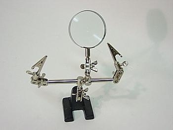

You can also buy or make a "third hand" solder helper, to help hold components or wires while you solder them.
Part of soldering is making a three hand operation with two hands...
