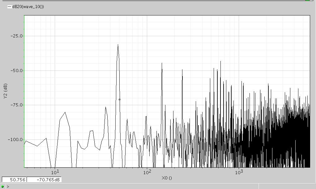

helllllllllo plz hav a look at cadence psd plot of SD modulator
what could be possible reason for spikes at other frequencies?????
I also could nt see perfect noise shaping??????
please help in figuring out the solution
My guess is that the modulator is resetting or saturating. Check the voltage at the output of each integrator.

Without any more information on the actual design, it would be guesswork. At any rate, start with an input voltage of 100mVp-p and check the loop.
