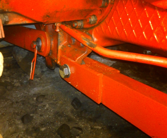

This design is a home made snow plow.
Parameters:
  • blade – 2005mm long, plate – 8mm
  • double-acting cylinder 32/20/200 shortened at 170mm stroke
  • front panel plate – 20mm
  • channel bars for the frame – 80mm
  • square bar – 35mm
  • turned hinges – fi 40mm
  • all movable joints lubricated
Hoses are connected to the second section of the distributor. Chokes were added to the actuator so that the plow raises and lowers more slowly. The skew can be adjusted using the pipe with drilled holes and welded steering ends of a truck. It can be set straight, diagonally to the right or left. The blade itself can be removed, it is combined with the arms by means of two heavy screws.
