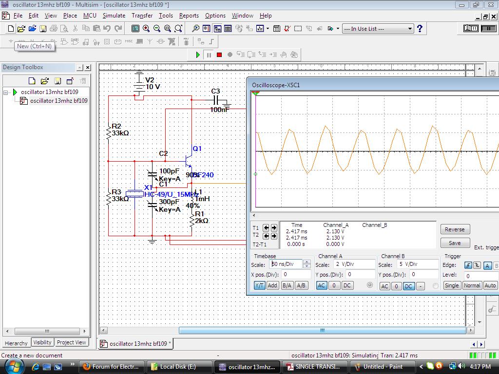

im tring to produce sine wave using a LC oscillator
but im getting output as shown in figure
can sumone give a hint how to improve the output??
I think your oscillator works well - as far as the simulation is concerned.
However, the graph does not look as desired because of timesteps that are to large.
Repeat the simulation with smaller timesteps - and you will be satisfied (I hope).

As your oscillation period is approx. 100ns I would use 100ps as the max. time step.

The diagram is of a crystal oscillator, not an LC one.

fareen, what really is the problem?
In your first posting you have presented a circuit and a simulation result, which has confirmed the oscillation capability of the circuit.
For my opinion, only the time resolution was not OK. So - what is the problem now?
The inductor in the emiter shouldn't be necessary. Try removing it. Also try changing the value of the 300pF capacitor to 100pF.
