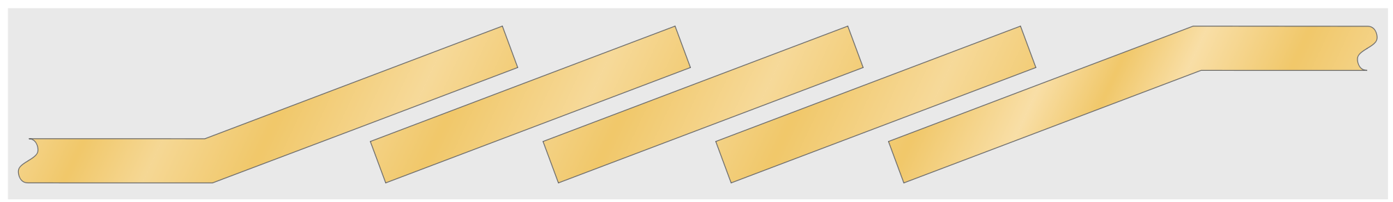

How can I draw the microstrip parallel-coupled lines in ADS (the file be attached in this post, shows the structure). In fact, these lines with unequal length, offset beginning position and desired angle are used frequently for designing the band-pass filters. suggested structure must be considered the coupling effect between lines.

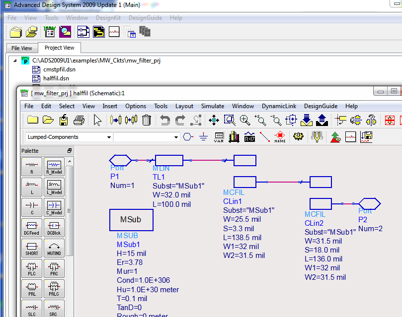

Have a look at the ADS example mw_filter_prj
thank you. but I think this structure is different with my request. Look at the angle of the strips.

Re: simulating the "Stripline parallel-coupled lines filter" on Advanced Design Syste
The only difference is the bend at the filter input/output. You can use element MBEND.
