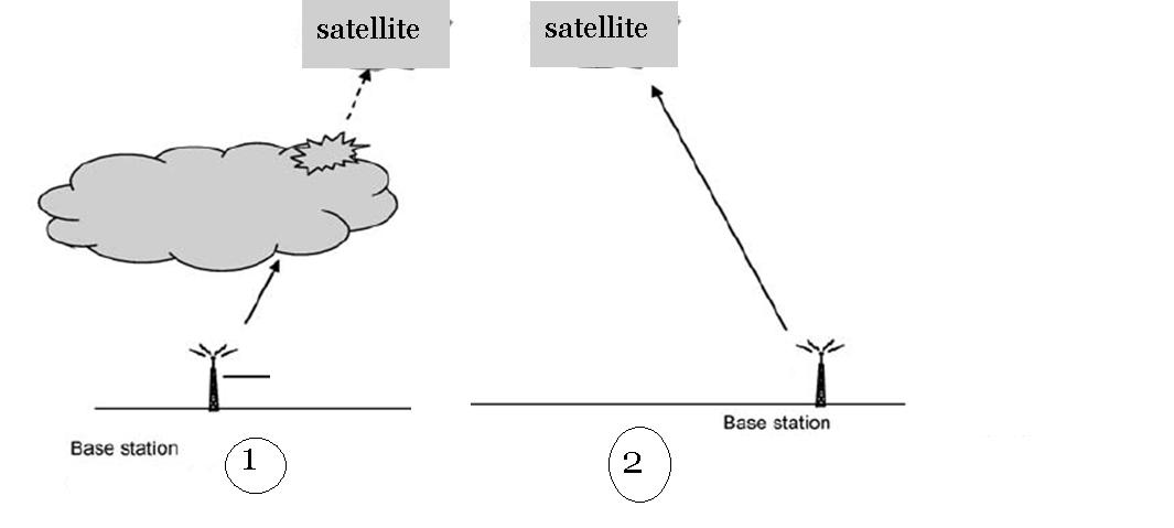

tnx jiri, any body else would like to help me. i asked my question in term of the propagation path and the elevation angle.
Pls check the attached image
Please read again what I wrote. For Ku-band, ITU-R recommendations offer a lot of useful data; rain intensity and rain-cell size differs over territory around the globe. In addition to rain attenuation, there is the depolarization. Your question can stimulate a full Ph.D. thesis to conduct a good research.
I would recommend the book by Gomez, J.M.: Satellite broadcast systems engineering, Artech House 2002, with a good analysis of a satellite Ku-band downlink.
