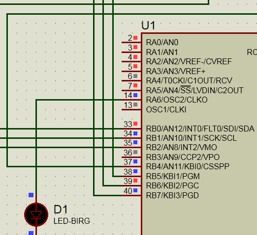

i can set all pin on all port to high using the output_high(). but this function is not working for PIN_A6....it stays on low....somebody tell me why?
Here is my code...

hi,
If I am reading your problem correctly.
When using an external crystal and HS, RA6 is a OSC pin.?

Is the circuit simulation or hardware?
Attach the circuit diagram.
Can you replace "output_bit(PIN,1); " these by output_high(pin_A6)

Actually i m using a isis simulation...and i m not using any oscillator...................
thank you
its a simulation.....
i used output_high(pin_A6) still nno effect..............:-?
#use FIXED_IO( A_outputs=PIN_A6 ) add this line after ADC Initialize...

PIN_A6 is 10th pin of PIC18F4550. Where pin 9 and 10 are used to connect crystal on that pin.
If you want to drive output on pin A6. You have to use internal oscillator rather than high speed crystal.
Simply wrong.
It's the other way round. If you are not enabling the low frequency oscillator 2, RA6 is available as general purpose pin. There's no cause in the post #1 code that stops RA6 from working as GPIO with output function. The code in flex_lcd416.c would normally not configure RA6, but we can't check it.
So it might be another Proteus bug. You can debug code execution in Proteus if you want to know what's going on.
No Port A pins are used in fluxlcd416.h......This is the o/p when all the port_A pins are enabled....
pin_A6 is giving Zero and PIN_A4 is giving nothing..........:bang::bang::bang:
The datasheet says that the RA4 pin is multiplexed with the Timer0 module clock input to become the RA4/T0CKI pin. The RA6 pin is multiplexed with the main oscillator pin; it is enabled as an oscillator or I/O pin by the selection of the main oscillator in Configuration Register 1H......Actually i didnt understand it quite well.....plz some explain ihow to config 1H register.....

Yes, that's right. The problem is that you selected HS oscillator option although you are using internal oscillator.
I apologize for my previous answer to hemnath's post. He already recognized the problem.
