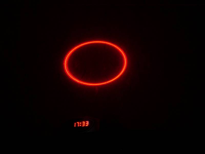

Circle:

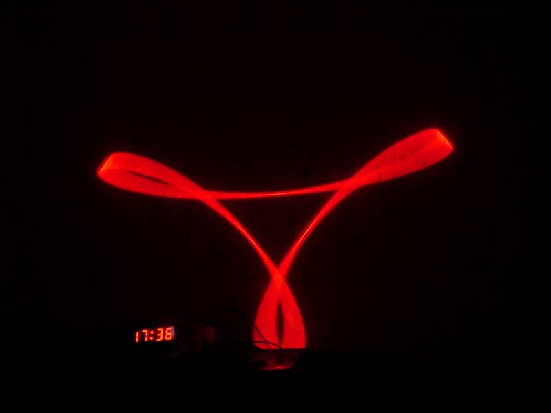

Triangle-like:

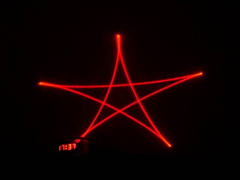

Five-pointed star:
