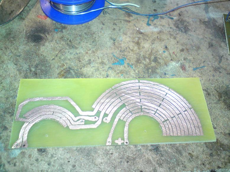

Resistors are mounting potentiometers used as adjustable resistors. Capacitors were experimentally selected to each 5 frequencies generated by 555 (500Hz, 1,5kHz, 5kHz, 15kHz, 30kHz). Frequencies were changed by adding a capacitor in parallel by what its capacity was enlarging. The power supply, generator and converters unit were made on one plate. A power amplifier which was stuck before on TDA 7394 plate was used as an amplifier:
The most important problem was switching the frequencies and work modes (sine, triangle, rectangle). Also rotary switches on the PCB were made:

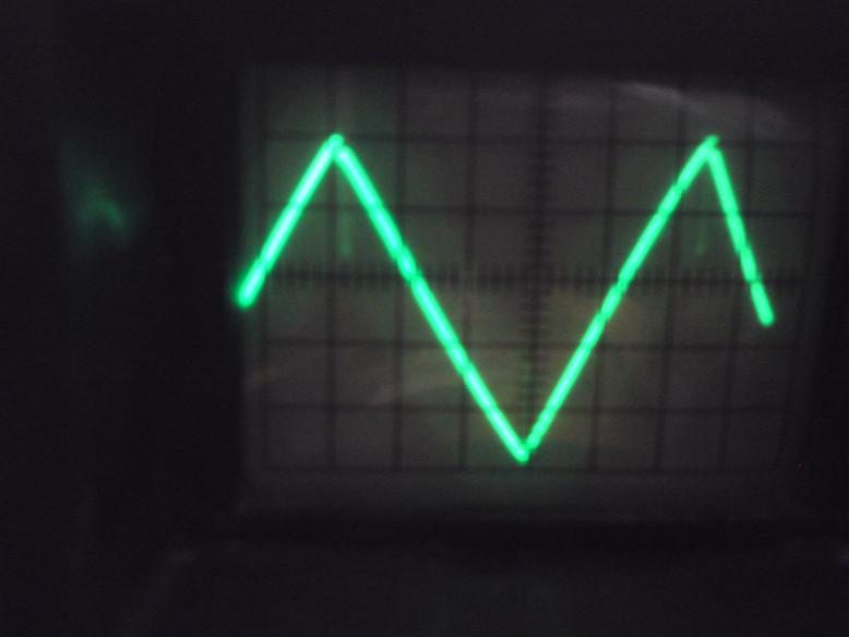

Amplitude: continuously adjustable at the amplifier input (0-1V).
Generated waveforms: square, triangle, sine-like.
With external power supply, the generator works properly.
Here are photos of waveforms:
