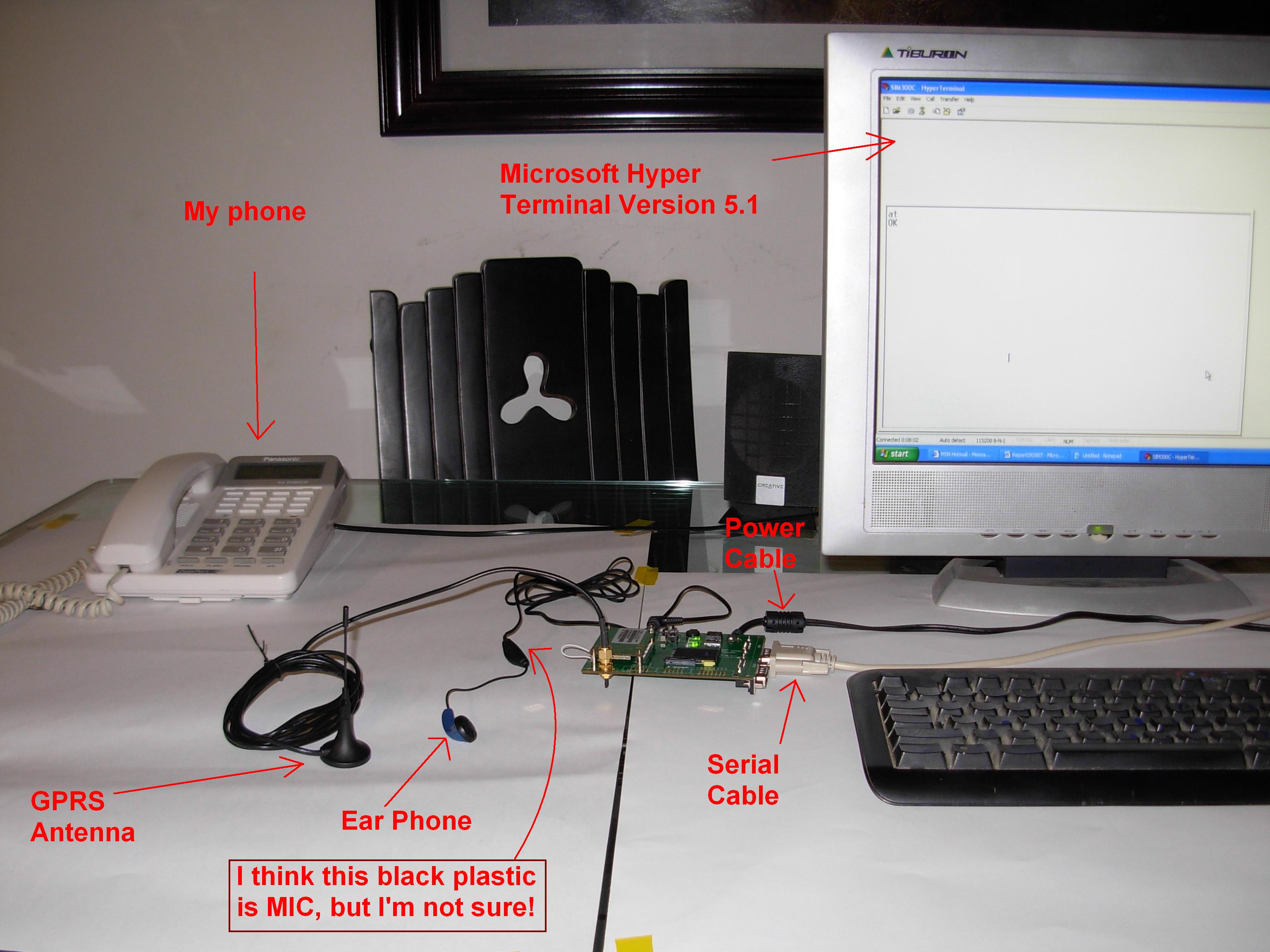

I'm an engineering student and I'm using Sim300C for my university project.You can see the layout in this picutre.
Question#1:
Is this black plastic thing a MIC in the above picture?

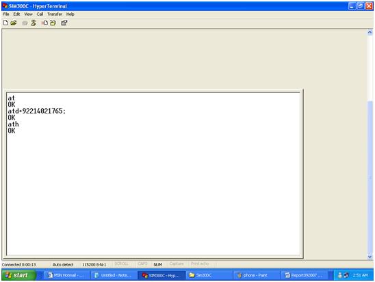

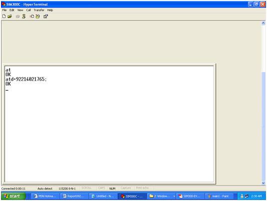

1)I now write the AT commands on the computer(Hyper Terminal).
2)My phone starts to ring after a little while, I picked up the phone and speak on the phone and tries to listen my voice on the ear phone.
3)I can’t listen anything on the ear phone and neither in my telephone set.
3) Now I’m disconnecting the call

sim300c headphone
try two rooms and a friend on the other phone
and speek into the 'black platic thing'
maybe there is a wire fault
ive picked up brand new headsets and sat scratching my head
till it dawns on me
im at a 'i bet myself its the ...' moment..duff cables etc
or a wrong connection
check it out and make sure the phone your using to rtx hasnt a setting to enable the headset mic or not
some people just use the headphone and actual phone as rtx and some phones do this
some networks wont allow two phones in a room and will shut down the audio of the calling phone to avoid feedback
gprs mic volume.. mic mute etc
audio on talk only setting within the software etc.... check this next

There is an AT command of CEXTHS, which when set detects the ear phone presence.When ever I insert earphone into the Sim300C evaluation kit, the Hyper terminal gives me the response about it's connectivity and whenever I remove the earphone it indicates me about it's disconnectivity.This proves that Cable is not faulty.

Hyper Terminal is just used to send the AT command and that's it.It's not concerned with any audio application of the module.It has no concern where I'm sending this AT command, it's just being used to send the AT command on the computer serial port.This proves that Hyper Terminal is not creating problem.

It made no difference which two methods I use:
1) Dial from Sim300C and recieve call on Phone.
2) Dial from Phone and recieve call on Sim300C.
But now my Problem Got Solved:
SIM300C is at the primary audio line by default.
This means that I had to connect a telephone handset to the handset
interface socket for voice communication, but I was using the earpiece(handsfree) for the voice communication.I then set AT+CHFA=1 for the earpiece configuration.Now I'm able to successfuly make the voice call.
Thanks for writing down your comments.Your suggestions really helped me to look and ponder at this problem from different viewpoints :)
Added after 5 minutes:
And yes, that "BLACK PLASTIC" thing is guaranteed a MIC :D
