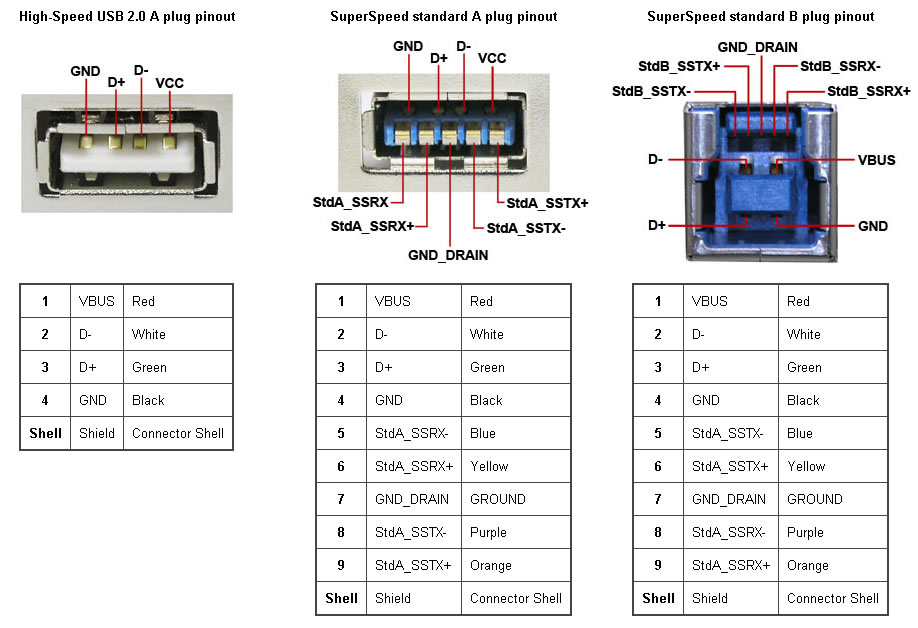

Let's start with defining pins of USB2.0 and USB3.0
  • The GND line provides a common ground reference between the upstream and downstream ports. The maximum cable length is limited by the voltage drop across the GND load.
  • The VCC lead provides power to the connected device (nominal 5V, but it usually differs from 5% 4.75 to 5.25V)
  • D- and D+ are the data lines please read below

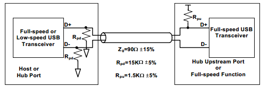

USB uses a differential transmission pair of data and uses NRZI encoding (non return to zero inverted). Take a look on the picture below:
The level characteristics of USB voltage:
  • static output swing of the driver in its low state must be below Vol (max) of 0.3V with a 1.5kOhm load to 3.6V
  • for the high state Voh (min) must be above 2.8V with 15kOhm load to GND
The receiver defines a differential '1' as D+ 200mV grater than D- and a differential '0' as D+ 200mV less than D-. The polarity of the signal is inverted, depending on the speed of the bus. Therefore, the 'J' and 'K' states are used in signifying the logic levels. In low speed, a 'J' state is a differential 0. In high speed, 'J' state is a differential '1'.

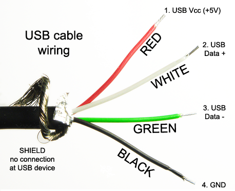

This trivial device is very easy to make by yourself, but let's start with making a test cable for further use. You can create a new cable or use an old USB cable. Just cut one end of it.
After that, cut the WHITE and GREEN cable. You will need only the RED +5V and the BLACK GND one. This cable will be useful for testing USB ports. Why do you need it? The answer is obvious – the multimeter pins are hard to place in a USB port. If you used an old USB cable, you can use the other side to get a DATA+ DATA- test cable. If you need a professional cable, just get for example Degson connector and screw all cables to it.
