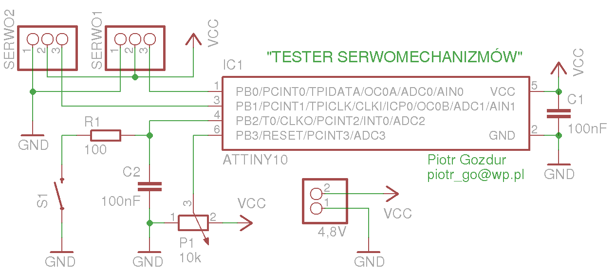

Program consists of three sests which can be changed by S1:
  1. position of servomechanisms adjustable using P1 (pulses from 0,9ms to 2,1ms)
  2. position of servomechanisms changed automatically (pulses from 0,9ms to 2,1ms)
  3. setting the servomechanisms in the middle position (pulses 1,5ms)
Frequency of pulses: 50Hz.
SERWO2 is set in opposite position than SERWO1.
Timer0 (Mode 14, Fast PWM) produces the signal.
Program was written in Assembler.
„Configuration Byte 0” = 0xFE
Schematic:

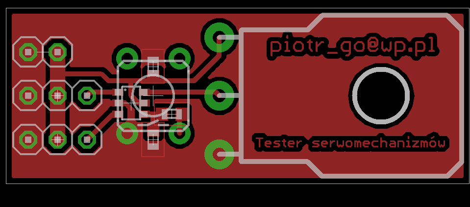

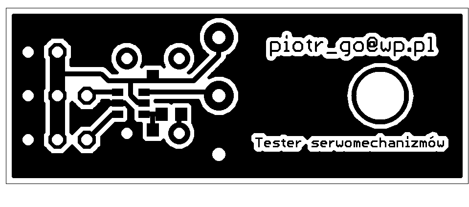

PCB:
View from the side of SMD components (600DPI):
Contacts and button should be mounted in the opposite side than the SMD, potentiometer threaded through hole from the SMD components' side.
The system was soldered on a universal board.
