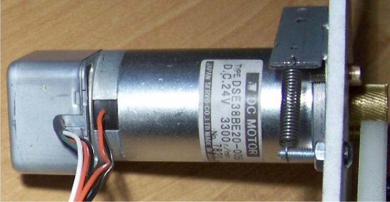

This design is a servo-drive based on a DC motor with encoder. The project is original and it is difficult to find information on similar issues on the Internet.
This interesting for many electronics design is based on microprocessor Atmega32 and was designed in C. It can be probably done by beginners. Distortions – the most serious problem that may occur while making this construction, can be reduced by using choke, shielding and gates with hysteresis.
Pictures:
