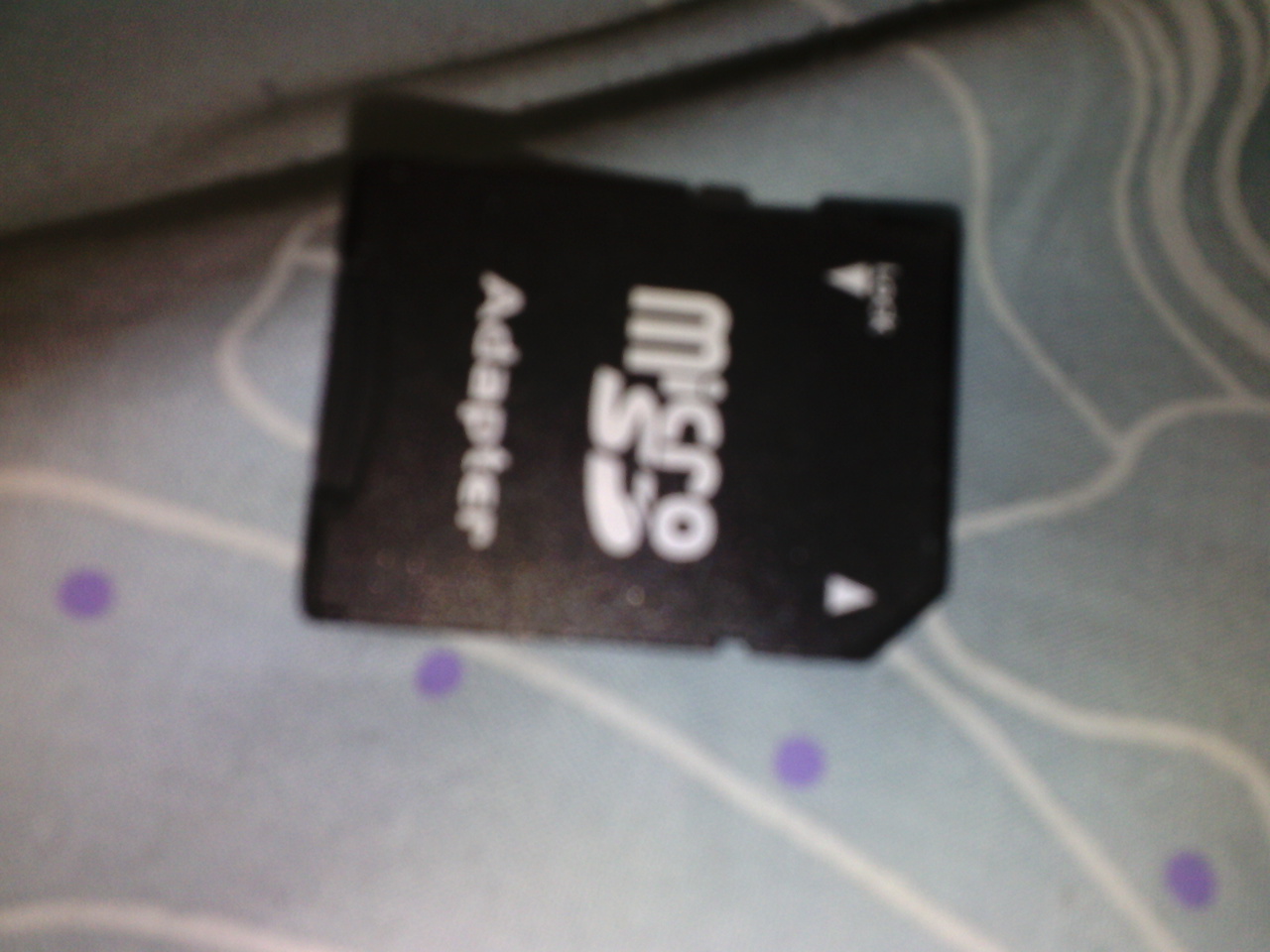

can I use this module with SDIO ?
is the same pin we used on SDcard ? only different on SPI and SDIO ?

Do any cards I have here can be used for SPI and SDIO ?
Please have a look at the attachment...
Does it mean I can use both interface with this application ?

So I can use this card for SDIO and SPI as well, please see the attachment
and this module for SDIO ?
Thanks
Yes, the card will accessed in SPI mode, as with most small micros. You need an adapter to plug the micro-Sdcard into a standard socket.
