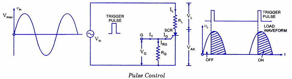

ok so if im understanding now, something like a moc3010 (non zero firing internally) can be triggered at any point of the wave like in
[image at www . circuitstoday . com/wp-content/uploads/2009/09/SCR-Pulse-Control-Circuit.jpg]
Now with a micro-controller my assumption is; when i add zero crossing circuit into it the controller it will know where i am in the ac wave regardless of how i trigger it, now if i put on MOC3060 in it (says zero crossing) that actually wont let the MOC close unless im on zero (so if im understanding its a another way to make sure you fire just at zero) (not what i want) now from looking at the code it looks like the micro-controller knows its zero when the 5 v pulse gets input into the controller and then in controller, then you tell it how many microseconds to delay, then it fires, changing this delay would alter when the triacs firing position (if it was to late im not geting all the power i could)
