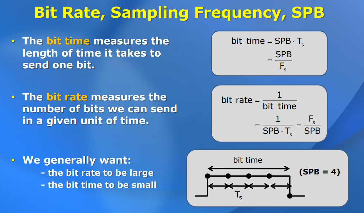

I attached four images.
What do they mean by samples per bits? Is this the inverse of resolution which is bits per sample? But if so, then SPB = 4 => bits per sample = 1/4??

Generaly "4 samples per bit" means, that in the time a single bit is transferred there are four readings of the logic state at the receiver side.
Those four values are digitally filtered to get a more noise immune and thus more reliable bit signal.
Also this ensures a reliable bit value for asynchrounous transfers where two independent clock sources (transmitter, receiver) are involved in the communication. To prevent from interferance effects.

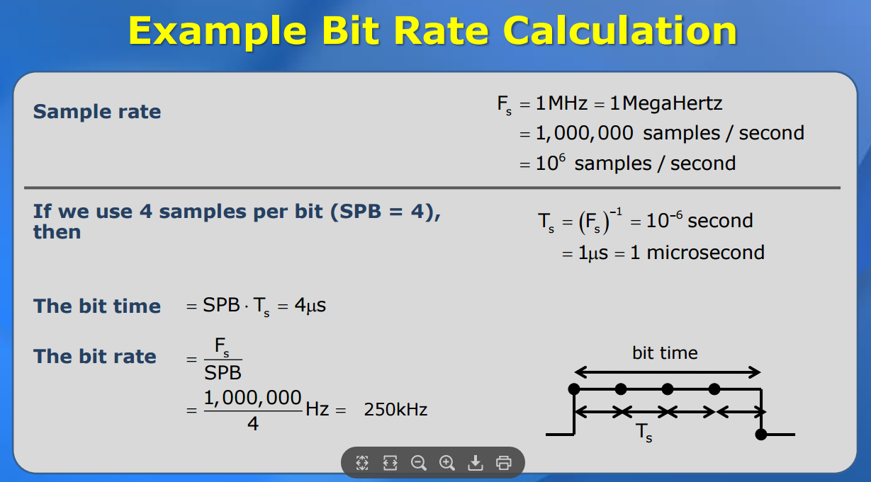

Consider the following problem:
"Consider a system that uses 8-bit ASCII codes to encode letters. How long will it take to transmit the bit sequence encoding "Good Morning" (not including quotation marks) if we use a bit time of 5 samples per bit, and transmit samples at a rate of 1MHz?"
Ignore the actual solution.
So, I have 12 characters in that string. That means that I need to send 12*8 = 96 bits. So, I send this sequence of 96 bits. And the bit rate is determined by the sampling frequency at the other end, right?
Oooor, I have the sequence of 96 bits. And at the transmitter part, I sample the 96-bit sequence with 5 samples per bit, and I send the 96*5 samples? So, at the receiver, I sample the sequence 5 times per bit.
What do I transmit? When am I doing the sampling?
Do I transmit the 96 bits and do the sampling at the receiver, or do I transmit the 96*5 samples?

There are two boards facing each other and the transmitting board uses a LED to send bits.
And to send a 1, the LED is switched ON. And it is maintained like so 50 us. And in these 50 us, the other board samples for 50 times with a sampling frequency of 1MHz (so one every microsecond). And the reason for oversampling is reliability, like KlausST said.
So, the sampling is done at the receiving part and 96 bits are sent.

In the simplest case with excess bandwidth like all UARTs Data is sampled at 16x clock for start bit then only centre sampled once per bit into a register byte then repeats for next character. 16 BYTE UART buffers allow consecutive bytes without loss, otherwise some latency or delay between words are expected so the Receiver does not miss and data sent. Thus 1 start bit (always =0) 8 data bits and 1 stop bit (always=0) means 10 bits * 12 bytes * 1us per bit = 120us. up to 16 bytes, then delay depends on handshaking of the serial port for flow control or a special character of data call XON, XOFF.

The bit time is equal to the number of samples per bit times the sampling period.
Thus, if I choose a bit time, then the receiver must adjust its number of samples per bit and sampling period in order to match this bit time. He can also trade-off between number of samples per bit and sampling period so that bit time is constant.
Or, If I choose a certain sampling frequency and a certain number of samples per bit, then the transmitter will have to adjust his bit time to match the requirements of the receiver.
And my question is: usually, who really decides first? which quantity is fixed? the bit time? or the sampling frequency and SPB?
My guess is that the transmitter sets the sampling frequency and the SPB, while the receiver will have to adjust its bit time.
