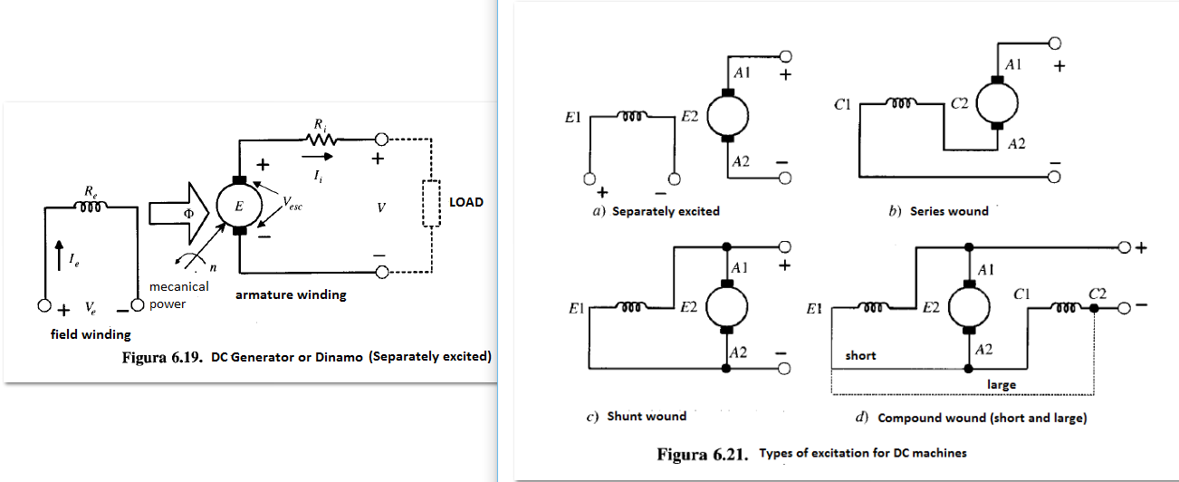

I have a dynamo (DC generator) that is connected to an old regulator which are used to charge a 24V 100A lead acid battery.
I have no experience at working with dynamos. I need to replace the old electromechanical regulator with a new electronic one. From several readings on the internet I understood that (and please correct if I am wrong) the dynamo has 3 connections:
1. "D" which is the output voltage/current of the dynamo.
2. "F" which is the input field current.
3. Ground.
The "F" connection should be used by the regulator to increase/decrease the field current which then increases/decreases the output at the "D" connection and keep the dynamo output voltage suitable to charge the battery and operate the system safely. Let's say this output should be around 26V.
Can you suggest a modern electronic regulator circuit to do this job? are there any ICs that can do this regulation?

Yes those are the main parts of it. I do not know how to implement electronic regulation but I think is good to know what type of DC generator you have since there are several options. Here are those options:
This sounds like a separately wounded mode...
Both dynamo and motors look very similar but they perform opposite functions.
Both have two sets of coils- one on the rotor and the other on the stator. Many small dynamos have the rotor made of permanent magnet and this is also common for small motors.
For motors the windings on the rotor and stator are combined in (i) series (ii) parallel (iii) series parallel. This mostly determines the torque output characteristics of the motor.
For alternators that uses slip rings instead of commutators, the rotation determines the frequency. For DC generators, the rotation determines the voltage. The current in the field coils are regulated to regulate the output voltage.
The boilerplate will have some vital statistics about the dynamo: power rating, voltage, etc. How the dynamo is driven? Diesel engine?

Yes is true, but a 28 V is considered small enough to have permanent magnetic field produced by stator?
3Deye, I think is useful to tell what kind of DC generator you have...what kind of excitation if it has no permanent magnets...
Having permanent magnets I do not think you can regulate EMF unless you play with speed.

Circuit provided by Warpspeeds is for a shunt wounded (figure C, post #2). Your motor/generator ~3kW so I think it is clear that has not permanent magnets for magnetic field.
To variate output of the generator in shunt wounded you have 3 options:
1) Vary speed
2) Vary magnetic field
3) Electric circuitry to change output which is what warspeed has done I think
To model in Orcad I think you could place instead of the generator a dependant voltage source. This dependant voltage source depends on the current through inductor "F -" (in the picture on post #6). This would work for a determinated speed.

So you are saying that it is a separately excited field not a shunt wounded ? If is going to work with the circuit provided, then should check it's characteristics in shunt mode because that way is going to work with it.
Separate independently excited field winding is the usual way these machines are made.
Without that feature, there would be no way to regulate the output.
I disagree with both statements.
1) The field connection you can do it yourself the way you want, you just need access to the filed windings.
2) It is possible to regulate output with 2 different ways:
First way: speed
Second way: place a resistor in series with the field windings.
SOURCE: Electric Machinery Fundamentals - 5th edition, Chapman - page 534
