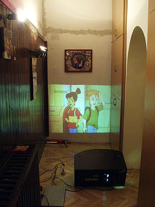

What’s inside:
Matric 15” MAG: contrast 500:1, resolution 1024x768
Metahalogen 400W
Fresnel lenses
Optical mirror
Object lens from Lumenlab
Four fans
Thermometer
All is mounted on MDF 10mm and painted Black.
Brightness is enough for evenings.
Temperature near matrix reaches 35 °C
Light source is separated with separate cooling circuit. Instead of glass there is a lens and it separates two cooling zones.
