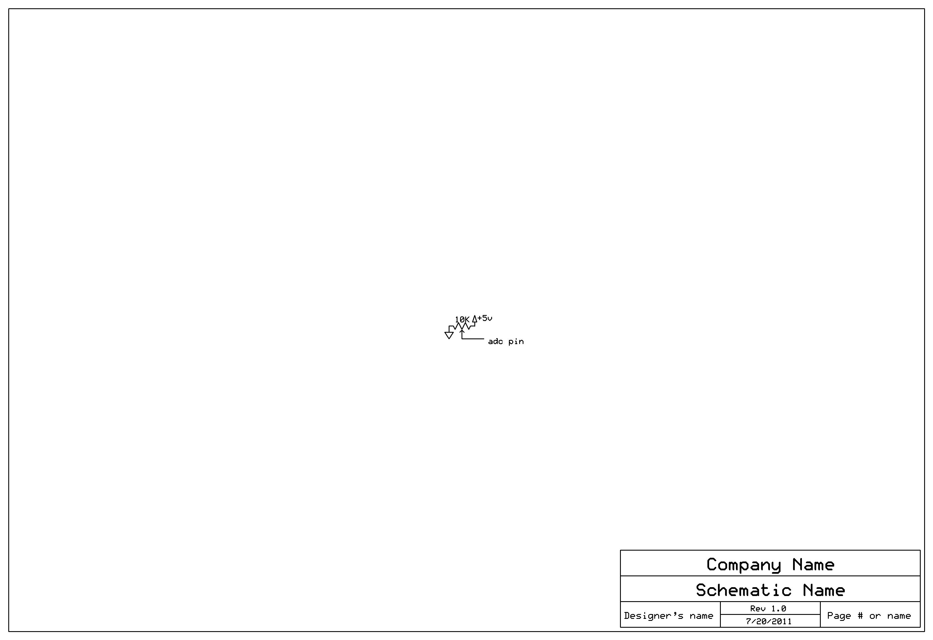

I can not understand what is the problem in this program. Error is the program can not being able to justify any portion of these conditions. I used "mikroC pro for pic".

One of your problems is this statement:
Code C - [expand]
if(RC6_bit = 0)
The statement, instead of testing if RC6_bit is equal to 0 or clear, always clears RC6_bit which is always false.
This is probably what you intended:
Code C - [expand]
if(RC6_bit == 0)
or simply:
Code C - [expand]
if(!RC6_bit)
I just glanced at the program, there maybe other errors.

The variable "ch" is declared as a type "unsigned char," however you are testing "ch" against type "float" literal.
The "ch" may have values ranging from 0 to 255, due to the fact it is an unsigned 8-bit value, this is a type mismatch.
if(RC6_bit = 0) this logic is working fine. but I changed unsigned char ch into unsigned int char as unsigned float ch shows error in my compiler. but still the whole program is becoming hanged into the low voltage sensing loop.

I believe the main problem is the oder of your "if's" on:
if((ch<=1.9)&&(ch>=1.30))
if(ch>1.33)
PORTB =0b11111111;
if(ch>1.40)
PORTB =0b01111111;
if(ch>1.48)
PORTB =0b00111111;
if(ch>1.56)
PORTB =0b00011111;
if(ch>1.63)
PORTB =0b00001111;
if(ch>1.704)
PORTB =0b00000111;
if(ch>1.78)
PORTB =0b00000011;
if(ch>1.85)
PORTB =0b00000001;
for instance. If value is 1.86 it'll hit the first (if), cause 1.86 is bigger than 1.33, ok?
My suggestion is to change the order. Start with bigger number (ifs) and go decreasing it.
I know it has been two weeks since you have posted this so maybe you have figured this out but I have to say a couple of things
Not if you want to check the value of the variable, you can't use assignment sign (=) to check for value.
the char, int, float are types, there is no such thing as a float char.
The types that your compiler supports are described in the manual page 168-169
so to declare a float variable you have to use float ch (or double ch which is the same)
cabelyn is also right, when you use an if/else sequence you have to make sure that you use the correct order.

Oh, Im really sorry. I forgot to post. I've already solved that and its working well.

You are complicating your code without a reason, it is not very easy to read this

instead you can simply use
Code C - [expand]
7
8
9
if(ch>1.85) PORTB =0b00000001;
else if(ch>1.78)PORTB =0b00000011;
else if(ch>1.704) PORTB =0b00000111;
else if(ch>1.63) PORTB =0b00001111;
else if(ch>1.56) PORTB =0b00011111;
else if(ch>1.48) PORTB =0b00111111;
else if(ch>1.40) PORTB =0b01111111;
else if(ch>1.33) PORTB =0b11111111;
else PORTB = 0x00;
And I see that you have kept if(RC6_bit = 0)
Why do you keep using that wrong way?
If you want to check for 1 then use if(RC6_bit == 1) or if(RC6_bit)
If you want to check for 0 then use if(RC6_bit == 0) or if(!RC6_bit)
Alex

i give u a sugestion , for Delay mode selection for user friendly... use 10k preset any free ADC port for time delay like sch.....
I think you wrote a program for a voltage stabilizer. So, the options for delay selection are 100ms and 5 seconds. The commercial voltage stabilizers have a switch with selectable options for 5-10 seconds and 5-10 minutes.
Reactions: a.t.r
    a.t.r
as per my sugestion .we can set time delay selectable options as 3 sec to 10 minutes.
i am right or wrong ?
---------- Post added at 01:02 ---------- Previous post was at 00:59 ----------
