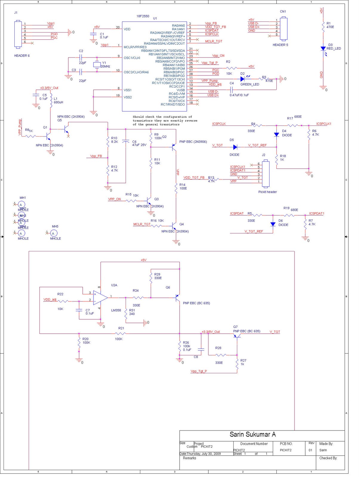

Hi dear wp100,
I made the pickit2 lite,although i tried a lot,i couldn't program a 3.3v chip with both option which you said,as a result,i made a ICD2 clone,but it didn't work as well.
there are lots of links and clones in this site,would you please put a workable schematic link for programming 3.3v chips here?
Thanks in advance.

This is my circuit virtually the same as Bluerooms PK2Lite ( in his circuit he specifes a ferrite but it is not really needed )
Have never tried an ICD2, seems the Pk2 clone is so much simpler and better.

I've made exactly the same "Bluerooms PK2Lite" and also i've used both methods,a 3.3v regulator after 5v of USB and 3.3v regulator in the circuit of my chip,but none of them worked and there was a VPP error.
I also checked it with MPLAB.
My chip was 18f67J50.
Best regards.

thanks a lot!!! i am a nubie and not sure how to use it....should i use the VDD delivering version or the previous one in which i hav to give external supply to the device?
---------- Post added at 12:21 ---------- Previous post was at 12:15 ----------
there are some crosses in the design on the emmiter of transistor q5 and some other pins? do we have to connect it like that?
