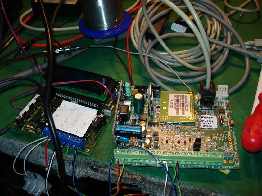

Dialer GSM was plugged to the relays in the model device.

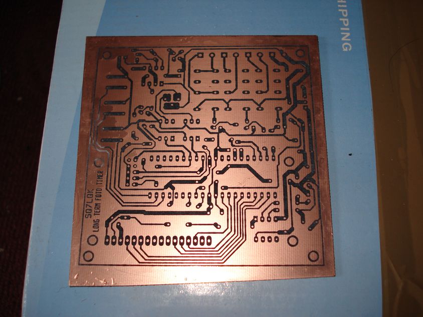

PCB made by thermal transfer method.

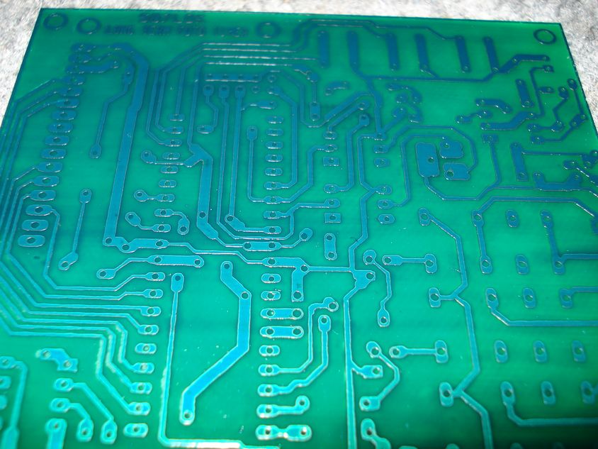

PCB painted with EnSolder lacquer.

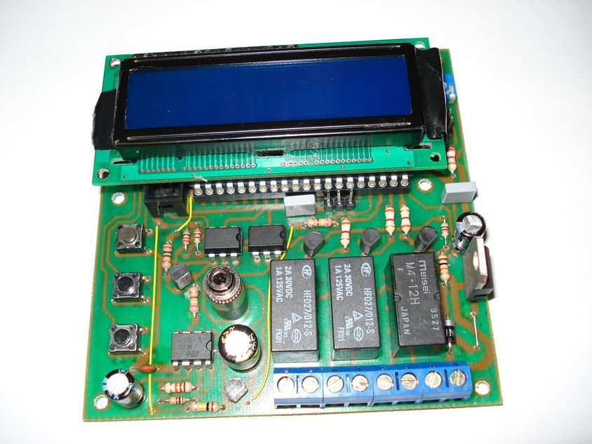

General view of the controller.

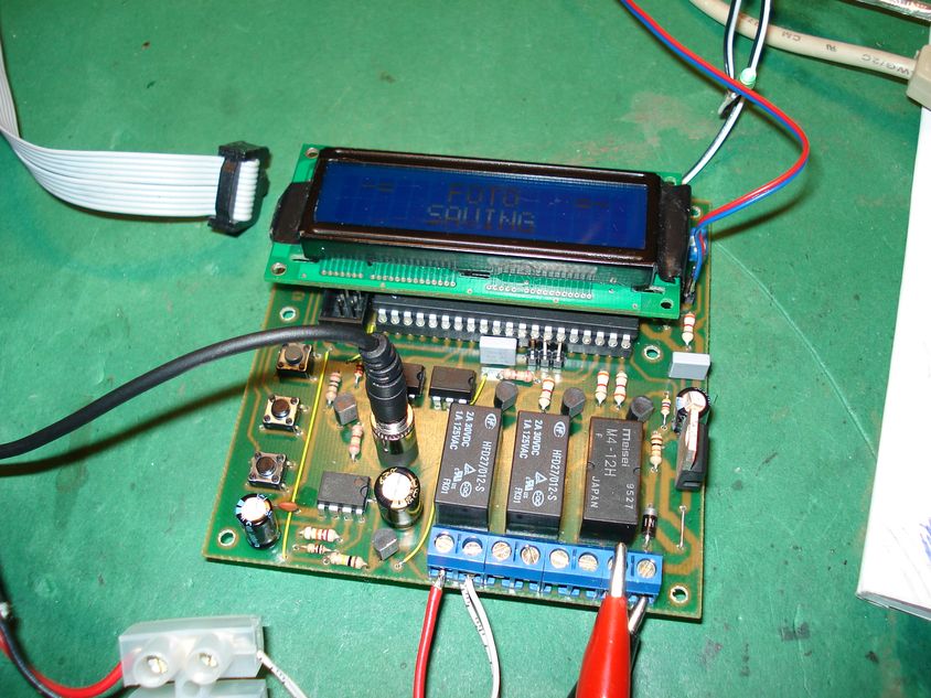

View of the LCD.
Testing.

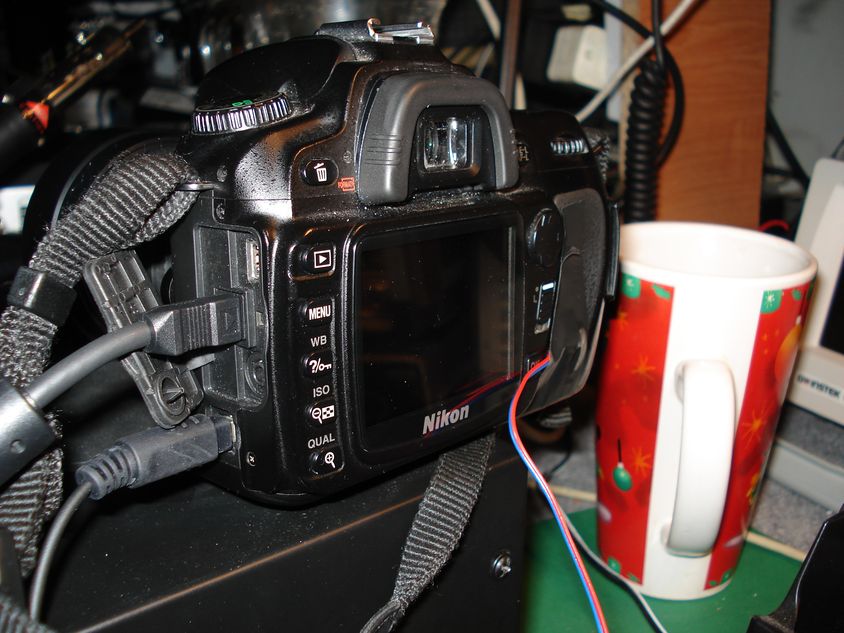

The way of mounting the sensor of taking picture.
