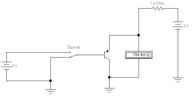

Xbee problams
it's my mistake, i decided not to ask for replacement.
to convert between interface i can use an PNP transistor, the digital output are with pull up resistors at the micro and at the xbee module:
it look like a good idea?
Re: Xbee problams
It looks fine for me, I wish you did it the first time.
Regards,
Laktronics
Added after 55 minutes:
But this 794 mv for 0 level is a bit high is n't it ? Try increasing 1K to some 3.3k and see how much voltage you get.
Regards,
Laktronics
Xbee problams
I realize that you want to use an emitter follower to keep from inverting the data, but its not a good idea. The emitter follower by design cannot drive a good logic low level. Regardless of the bias resistors, Vol will always be about one diode drop above ground.
I would suggest moving to a common emitter configuration with an NPN. You will need two of these in cascade to handle the logic inversion. This is assuming that the output of the micro is from a dedicated port like a UART. If you can produce one of the logic inversions inside the microcontroller via software, then you only need one external NPN in common emitter.
Philips, Fairchild and others make some dedicated logic converter ICs. These are designed to interface across logic families like this. In the final design you may want to consider these ICs as you can pack several signals into a signal chip with a much small board area.
Xbee problams
banjo, i dont think that it may be a problam, Vil on xbee is 0.2*vcc=0.6v, and the transistor Vce is less then 0.6 :O
but do you have an circuit exampe of your suggestion?
Xbee problams
I am no expert on Xbee, but I would guess that the 0.2*vcc is the Vil(max). They guarantee that the chip will work up to the max, but not beyond. Anything about 0.6V is may be read as a one, not a zero. Usually the zone between Vil(max) and Vih(min) is a dead zone where the logic level the chip will choose is undefined. You are not supposed to stay in this zone only rapidly transition through it.
It is not considered good design to operate right at the limit. For common emitter configurations, the governing parameter is Vbe and not Vce. The transistor cannot pull the emitter terminal lower than the base in common emitter. Since the base will be driven by the 5V microcontroller, its lower voltage limit could be around 0.2V. The emitter MUST be 1 diode drop above that. Even if you assume an 0.6V diode, this still puts the voltage at 0.8V. If the microcontroller pulls all the way to ground and the Xbee is forgiving, it may work for some devices at slow speeds.

Sorry for the typo. Your proposed circuit is common collector. Vbe is governing parameter in common collector. I mis-typed the name of the configuration above, but the concept is the same.
Re: Xbee problams
Hi Ngel,
What Mr. Banjo has told are important points to be kept in mind when you deal with general logic circuits, many logic family will not tolerate high Vil levels and its noise immunity will reduce even if it works under lab conditions.
But in your specific case, Xbee quotes a figure of Vil = 0.35 *Vcc under electrical characteristics of their user manual which gives you adequate margin for your circuit and you have no reason to worry. In your case even a simple resistive divider with low value resistors might work. But for your future designs using multilogic devices do not underestimate the need for usage of standard logic converters.
