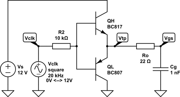

Mosfet gates must be driven both on and off. The TL494 cannot properly drive a MOSFET gate directly. The image in your first post will drive the MOSFETs on, but not off. A simple way to drive MOSFET gates from this IC is by using a PNP/NPN totem pole driver between the TL494's outputs and the gate of the FETs.
Something similar to this works quite well. The output from the TL494 would connect to VClk point and the MOSFET gate would connect at the Vgs point. You would need one of these circuits for each MOSFET. The capacitor Cg is only a representation of the MOSFET's gate capacitance and would not be part of the actual circuit. Obviously the type of PNP/NPN transistors and the resistor values in this circuit would be dependent upon the MOSFETs you're using and the amount of drive current required to turn them on/off at the speeds you require.
