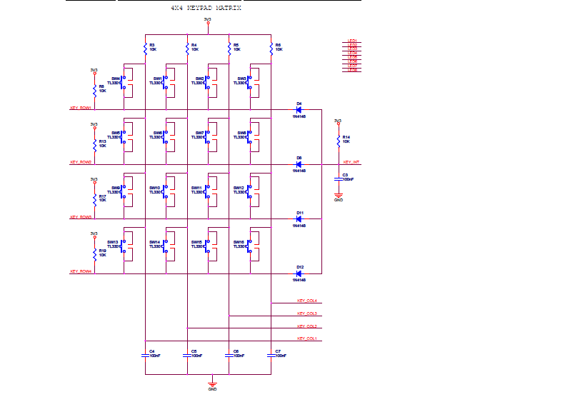

Hi guys
I am trying to interface the 4*4 matrix keyboard with lpc2148, I wrote the code for that, and to display the key pressed in the lcd, but it didn't work.
The keyboard connections:
columns: column 1 to column 4 connected to P1.21 to P1.24
rows: row 1 to row 4 connected to P1.17 to P1.20
LCD connections:
the 4-bit data: from P0.19 to P0.22
Enable: P0.10
R/W: P0.12
RS: P0.13
Here is the code:

  IODIR1 = 0x01E00000;			  //making rows as I/P and columns as O/P
void init_lcd(void)
  IODIR0 = 0x00783400;
  cmd(0x28);
  cmd(0x01);
  cmd(0x02);
  cmd(0x06);
  cmd(0x0C);
unsigned char read_key()
  int row=0,col=0,i;
  unsigned char f=0xFF;
  row = IOPIN1 & 0x001E0000;
  IODIR1 = 0x001E0000;			  //making rows as O/P and columns as I/P
  col = IOPIN1 & 0x01E00000;
  f = decode(row,col);
  return (f);

HI Mr.lulezo
in your program you have set IODIR register only rows as I/P and colums as O/P ther you need to make all are as I/P only in IOSET register you make row as 1 and colums as 0 thn tht will work if u make colums as O/P how the device will read and identify the key press. make that change and tyr you will get it.
