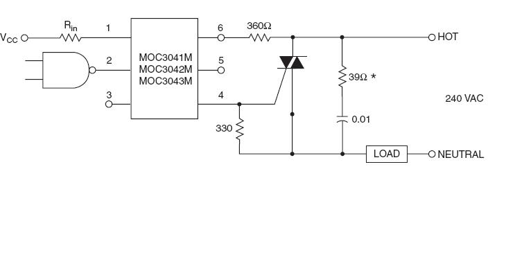

I found the circuit below with the datasheet.
But, I have questions here:
1. My load are 2 heaters, each 1000W. Is this circuit supports the heaters, I mean are the heaters considered as a resistive load?
2.The MOC 3041 will detect the zero -crossing, OK. But When I make LED Hi, when should the internal triac conducts. Well, I cannot understand the way of it. suppose the LED Hi when the main voltage at a certain time at say, 100 v and at that point LED goes hi, and then goes down. what will be the result. the zero croosing point did not detected, so there will not be a cutting for the cycle in spit of that the LED goes hi.
I miss understande?
Re: Plz Help me
Q1 - thats about as resistive a load as you can get - just measure them with your ohm meter.
If you have a fan included in the same circuit the fan is considered an inductive load.
For a load of 2kw you will need a large Triac and a good sized heatsink, and be aware that depending on how you mount the triac the heatsink may also be live.
At those power ratings you do not get many second chances !!
Q2 - these pdfs should help answer your points -
http://www.soloelectronica.net/triac/AN_3003.PDF Non Zero
http://www.fairchildsemi.com/an/AN/AN-3004.pdf Zero
