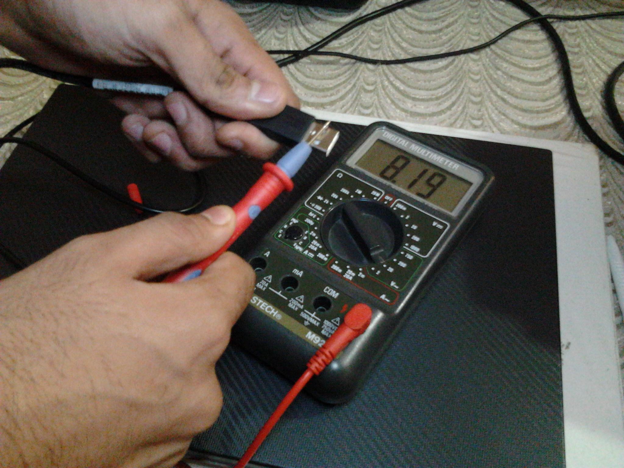

Sorry,what i had told about having a electrical shock when i touched the USB cable was my mistake, yesterday i felt a shock and tested it with a tester and got the tester's led light up..so i didnt touch it and feel anymore..
But today i touched it again and felt no electrical shock and tested it with tester again and got the tester's LED light up, then i took my Multi-meter and measured the DC voltage from adapter and got a correct reading of 30Volts ,and i took a single positive probe and got around 9 V Ac current, every metal connected to the printer and the USB which is also connected to the printer gave a 9V AC when probed with positive probe of the multi-meter
below is a image of the reading and the way i tested it... please tell me is this is a AC current leak? i cannot feel any shock and the USB works 100% fine with my computer
and would this small current damage the PC?
what could be the reason?
1. Try with other multimeter, I dont trust to this small multimeters.
2. Try with new PC power supply.
3. Can be motherboard USB defect.
How could it be related to Mother board of my PC ?? the whole Printer mother board has got some AC leaking to it,it has got nothing to do with my PC mother board and definately not a problem with my USB coz its working fine when i print through my computer or maintain the printer with my PC..
I have been using My PC,laptop,Sound system,TV, every socket in my home has got good grounding,there is no grounding issue,i have never felt any shock when i touch my CPU,or any electrical item in my home
the problem is with the printer i think,the printer power plug has only 2 pins and no ground pin,so the transformer in the adapter does not have a ground and it is leaking some AC to the output,so the tester is picking up the AC current,but the AC current which is leaked is less than 9V and it doesn't give any kind of shock,i think a correct value of capacitor would stop the AC entering from the power adapter to the printer... this is my theory on this issue,if i am wrong please do correct me
