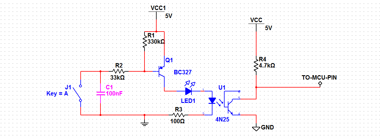

I want to drive a Opto-coupler through a Transistor.
when my input is zero(below 2.5V) the transistor should turn on to drive opto-coupler.
if my input is greater than 2.5V means the transistor turn off.
how to calculate the biasing resistor and which bias is preferred?.
this circuit is used with microcontroller operated with 5V power supply

I designed some circuit(for 0V the circuit ON) please help to which one is correct.....
this one
OR this one? and WHY?

In your circuit the opto will only switch off when the input gets above about 4.5V. Anything below 4.5 and the opto will start to switch on. This can't be used with the (2.5V ±0.5V) requirement in your first post.
In my circuit biasing method and capacitor connection is correct or wrong?.How to calculate the capacitance value and resister value?

From your circuit on post #11, I see a switch that could be closed (0V and 0 Ohm) or opened (0V and infinite resistance).
Is this your actual circuit?
Or is this switch (J1) drawn as an equivalent element for an output (as an open collector or drain)?
no J1 act as input (when input is 0 turn on the transistor)
Now my Doubt is Is my biasing resistors are correct or wrong?
how to calculate biasing resistor value?
NOTE:forgot about my conditions (2.5V + or - .5V)
It is not hard calculating the values of the biasing resistors. But before I do it, I like to point out that if there is a mechanical switch, the transistor is not needed. The anode of the external LED will be connected to VCC1 and R3 is connected to the switch J1 instead of ground.
Now let us be back to transistor Q1.
We start here from knowing its Ic (collector current) when it is on:
Ic = (VCC1 - Vce_sat - V_led1 - V_ir) / R3 , [equation_1]
VCC1 = 5V, [given_1]
Vce_sat = 0.2 V , estimated value of the saturated Vce, [estimated_1]
V_led1 = 2 V , typical value of red LED, [estimated_2]
V_ir = 1.2 V , typical value of IR LED (the opto-coupler input), [estimated_3]
R3 - 100 Ohm, [given_2]
Ic = 16 mA , [calculated_1]
This current is relatively high for the 1mA load at the output of the opto-coupler.
If you like to reduce it, say to 2 mA, you can also use [equation_1] to calculate R3 and choose the closest standard value (lower of the result).
In this case (saturated Q1), the ratio Ic/Ib could be estimated about 20.
G_i = Ic / Ib = 20 , [estimated_4]
Therefore:
Ib = Ic / G_i = 16 / 20 = 0.8 mA , [calculated_2]
We also assume the current in R1 from Ib*0.1 to 1*Ib. A higher current (I_r1) lets R1 be smaller and this gives faster turn off and better immunity to noise. Here even I_r1 = Ib/10 is fine but let us assume:
I_r1 / Ib = 0.5 , [estimated_5]
From [calculated_1]:
I_r1 = 0.5 * 0.8 = 0.4 mA , [calculated_3]
But:
R1 = Vbe_q1 / I_r1 , [equation_2]
where:
Vbe_q1 = 0.7 , the diode forward volatge , [estimated_5]
R1 = 0.7 / 0.4 = 1.75 Kohm , [calculated_4]
R1 = 1.8 Kohm , [result_1]
The actual I_r1 can be found with [equation_2]:
I_r1 = 0.7 / 1.8 = 0.389 mA , [calculated_5]
Now:
I_r2 = Ib + I_r1 , [equation_3]
I_r2 = 0.8 + 0.389 = 1.189 mA , [calculated_6]
And:
R2 = ( VCC1 - Vbe_q1 ) / I_r2 , [equation_4]
R2 = ( 5 - 0/7 ) / 1.189 = 3.62 Kohm , [calculated_7]
R2 = 3.3 Kohm , [result_2]
Ic/Ib is known as Beta right?
for my transistor Beta value from 160-400.
then why we choose 20.
For R2 resistor?
You are right "mailus", Ic/Ib is Beta and it is usually given on the datasheet when the transistor is in its linear region (for Vce not close to zero volt as in our case here, Q1 is saturated).
About R2, please re-read my previous post, there was a mistyping :(
R2 = 3.3 K
typing error I_r1 is 0.389uA (0.7/1.8K)
I_r2 is 0.8ma
R2 = ( 5 - 0.7 ) / 1.189 = 3.62 Kohm , [calculated_7]
R2 is 5.3K= ~5.6K
is it correct?
