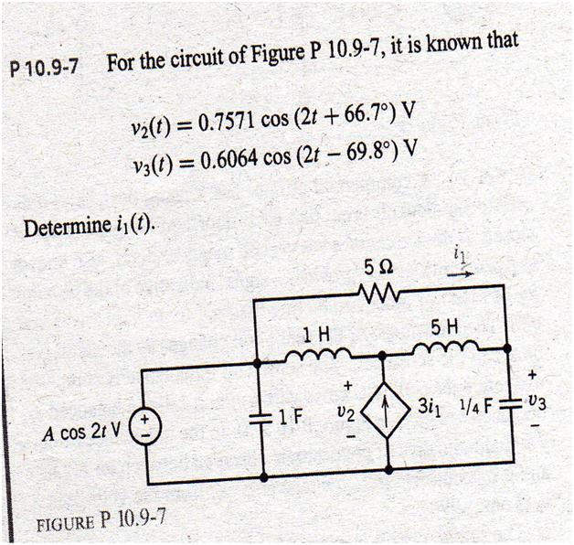

i1=(Acos2t-0.6064cos(2t-69.8 ))/5

i know how to solve this problem using mesh analysis but the only problem is how to solve the unknown A? in the given independent source,,and by the way the only given in this problem is the voltage drop at V2 and V3,,did you see that,,how are you going to solve this in oder way using nodal analysis,tnx

tnx for the answer but i nid the solution,,can u pls show me the solution??how did you solve that??what particularly technique did you apply in that equation,,,are you using mesh analysis or nodal analysis techniques???tnx,,pls reply asap

5) The problem does not ask you to solve for A. I did not solve it either.

With all that said I am going to tell you just his, the secret is in the minus sign.
You figure it out.. Let me know if you do....

i can't get the answer you gave to me,, i try to solve this,,,pls i know that you know this,,,can you pls show me the solution so i know where part of solution i go wrong,,pls,,,i nid your help,,and its my pleasure if you help me,,,thnaks for answering my question,,i am looking forward for you reply and help,,thanks a lot,,:)
You're not looking carefully enough at the problem.
What is the voltage across the 5ohm resistor? Write it down.
Now look at the voltages around the outside of the mesh. Two of the voltages are given to you (v3 and the voltage across the 1F capacitor).
You said you knew how to do mesh analysis. If you simply write the voltage relationships around the outside loop of the mesh, you'll have your answer.
Post again if you still don't see the answer.
