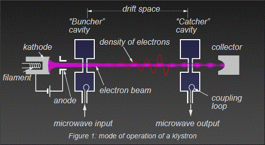

We are radar vendor. And we use Klystrons to amplify signal to near 1MW. We use CPI klystron tube. You can google CPI.
Hey Tony
interesting stuff and some WOW specifications :) one there, for 3kW output, its producing 9kW of heat!!!
maybe I need to revise my understanding of klystrons. I had always been taught they were oscillators and not amps. looks like they can be both.
Dave
PS been doing a bit of reading....
very similar to the TWT ... we live and learn :)
Hi, Dave,
In the picture you posted, obviously there are a microwave input port. That determines the output frequency. And the klystron can work in a bandwidth, say 50M. But it only output a 5M bandwidth pulse signal.

ok .... are klystron amps typically narrow band ? 100MHz or so, or are capable of multi GHz bandwidth as a lot of TWT's are ?
Dave

Hi, Dave,
Klystron Amp are narrow band, the klystron of CPI we used only have 50M bandwidth.
And weather radar pulse is as narrow as 0.2us, that is 5M bandwidth, SO klystron is fitable.
