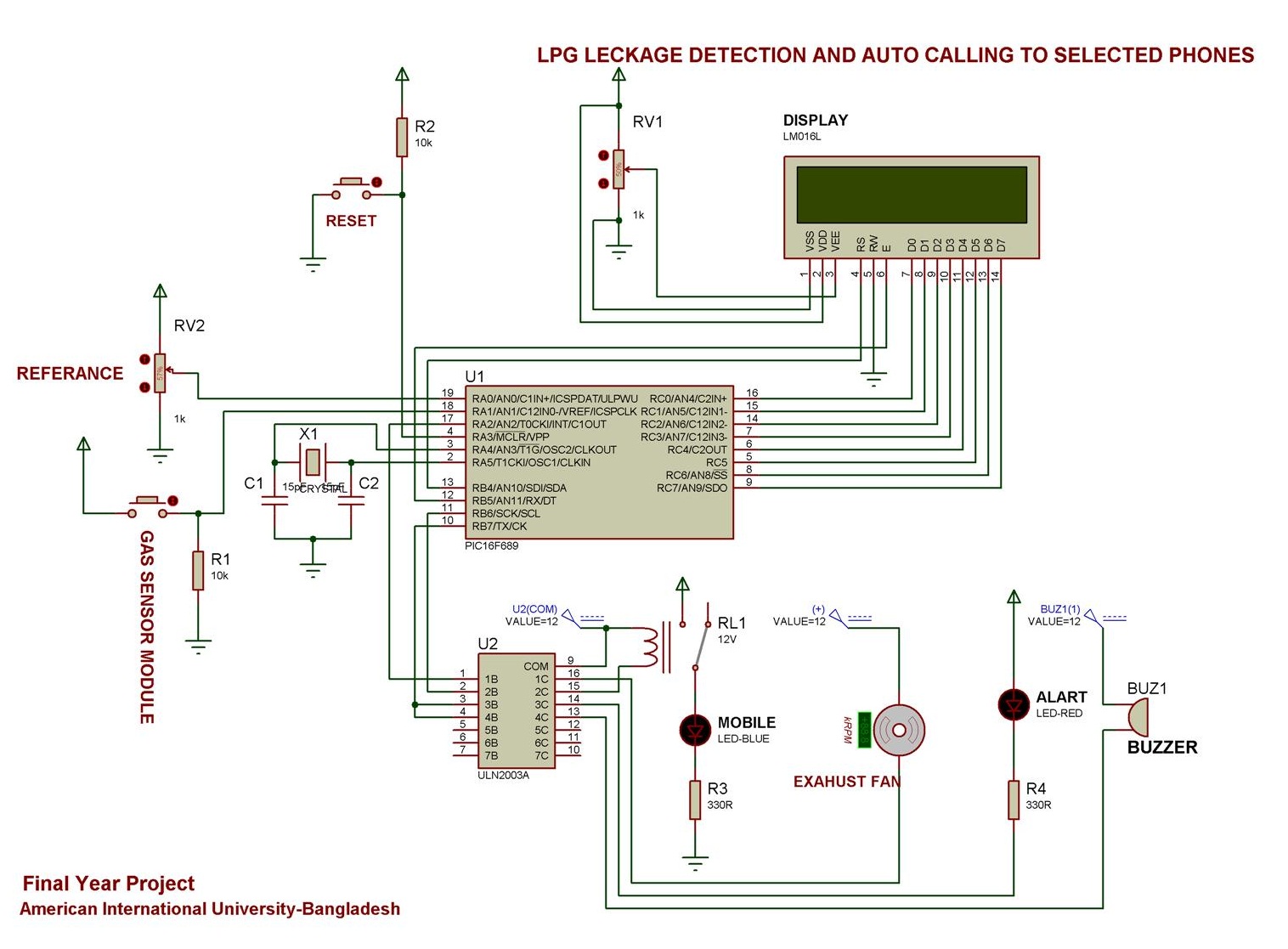

hi guys ... i am in problem with my favorite PIC16F690 and stupid LCD(16*2) . In Protues ISIS its work awesome. But in practical LCD doesn't display anything...i am really getting Upset :roll:. U guys can help me from this ****....... [MODERATOR - NO FOUL LANGUAGE]
and Can u guys help me to convert this into 4 bit mode. Just LCD part.
My code :

Main CKT:
When you indicate, "LCD doesn't display anything," does this indicate literally nothing or are there black boxes?
What is the exact model of LCD you are using in your physical hardware design? Do you have a datasheet for the device?
Issues concerning LCDs performing as expected in simulation versus not performing as expected with physical hardware are often due to improper initialization and timing delays.
Just glancing at your code there appears to be an insufficient delay to allow the LCD power up to ready state before issuing the initialization commands. All LCD controllers require a certain time period upon receiving power to initialize themselves internally to a known ready state before any commands are issued to them. The specific time delay varies between controller chipsets, manufactures and other factors. The required startup delay usually ranges from 50ms to 150ms, with a longer than needed delay having no ill effect.
I would suggest placing a 150ms delay in your code before issuing the first command to the LCD. Also you are using a set 10ms delay for all commands in both the LCD_ini() and LCD_data() routines, this maybe too short a delay for the initialization commands and longer than needed for the operational commands. In most LCDs the monitoring of the Busy Flag is the preferred method rather than a fixed delay when issuing operational commands.
Once you have identified the exact model of the LCD in your design, more specific delay requirements can be suggested.

i real world is Connection Mistake..
First Check Your Connection Properly.
To convert it in 4-Bit mode..
Just have a look in your Samples Folder where Hi-Tech C Installation occurs.
It will have a samples Folder in which you will find LCDDemo..
That uses 4-Bit Mode
I would strongly recommend that you debug the LCD interface in 8-bit mode, before attempting to convert the design to 4-bit mode.

I'm having the same problem with LCD interfacing with pic16f690. Its ok in simulation. Also other programs are working well in real circuit but only there is no output in the LCD display. I triple checked the connections. connections are all ok. but no output in the LCD. what may be the problem?
Its ok, I found the problem. The LCD along was faulty. All ok...
