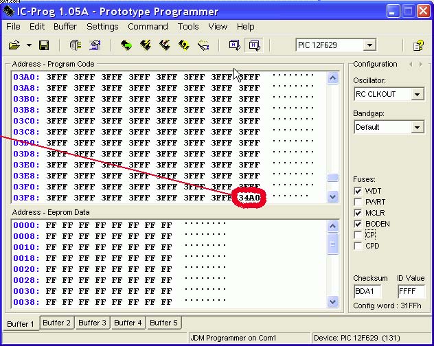

I have erased whole PIC12F629 including calibration value. Now how to put again those values. Please suggest.
Hi, you may use ICProg to put call value, see picture,
regards
Thanks for reply. Should I program 34A0 value in that area. Can you please give me location where should I copy this value.

The 34 is a RETLW instruction, the bit we're interested in is the calibration value. In the example above it is 8C but it will vary from one device to another which is why it is important to know the actual value in each PIC.
it's mean that calibration value is 34XX, but XX is factory calibration for each pic, well you can try a value like 34A0 or 348C or many others
"If you have lost the setting you can calculate a new value using the project here"
but the link is dead
maybe help you :
http://picprojects.org.uk/projects/piccal.htm
Thanks for the link. Nice article. Thanks again.
Hi, Which tool did you use to program and erease the PIC ?. Some programs like MPLAB store the cal value in a file on your harddisk :)
I used SmartProg universal programmer.

The SmartProg programmer has a feature which preserve the calibration bits, but I made an mistake and erased whole device.
