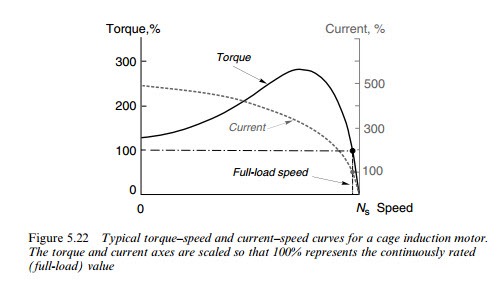

Well, the question asks for a decision between two alternatives, but the first is wrong and the second technically impossible.
"Constant V/f" actually means that the voltage is varied according to motor frequency, not the other way around. And the simple fact that the three phases have fixed 120° phase shift involves that they must be driven with the same frequency.
There are VFD drives that reduce the frequency in case of overload, but that's a different topic. I'm not aware of a VFD drive implementing "voltage feedback", instead there's an inverse feed-forward from bus voltage to duty cycle to keep the output voltage constant.
I notice that you finally managed complementary waveforms in the latest simulation, but the duty cycle doesn't seem to cover the 0 to 100 % range, as required for full output voltage.

In Three Phase AC Induction Motor if load varies then V varies. So, I feed back voltage to PIC adc and monitor it and based on this adjust the PWM duty to get constant V for all possible loads ?

To complement what C-Mitra mentions:
if he motor load increases, the rotor slip increases which has two effects:
-the speed decreases
-the torque increases.
That is the way induction motors work. See curve below:
[found at: machineryequipmentonline .com /electric -equipment /wp -content /uploads /2016 /01 /INDUCTION -MOTORS -ROTATING -FIELD -SLIP -AND -TORQUE -0580 .jpg ]
The peak of the torque curve is called breakdown torque. If that value is exceeded, the motor will stall.
