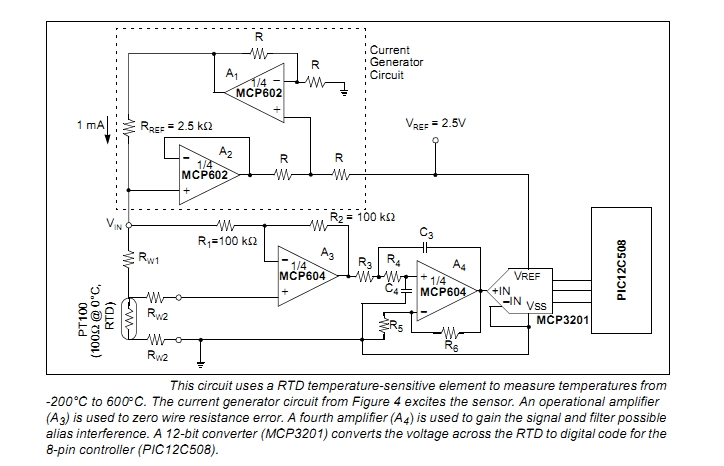

the idea to interface temperature sensor to PIC is shown in attached figure.
it uses PT100 RTD and PIC 12c508 for better start
Reactions: KerimF

Thermocouples may be cheap, but a circuit to convert the uV output to PIC is not. RTDs are made from platinum and cost like jewelry. A thermister would work here; it is pennies and interface is a pullup resistor to an AD input.
