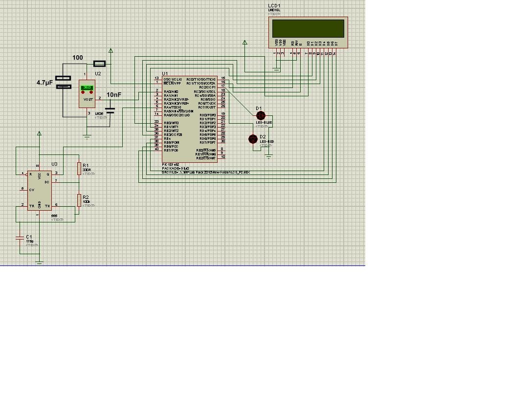

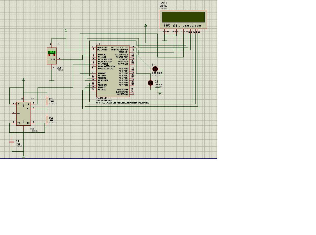

in order to check the modifications in LM35 circuit i grounded the RA4 pin of
PIC and then analyzed the effects

Not a picture, but just the drawing of the schematic. If possible.albbg, are you asking about the picture of real circuit which is on project board ?
as it will be a little difficult of taking an intelligible picture due wiring ....
thanks
