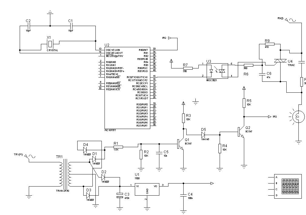

hello i h've been working on a phase control light dimmer project with pic 16f877 microcontroller with ccs pic c compiler driving a MOC3021 optotriac
controling a lamp 220 v 50 hz .i can say that i know the principle well ,so i wrote this c code,and for some reason it does not work.
well in this case i am trying to control the lamp at 3 defrents phases 100,75,50 %
int porcentage=100;

I assume you are working from a zero cros point and controlling a triac! Is this correct? When you say it doesn't work what do you mean exactly/ What happens?
dfullmer
Your logic seems to be correct.
Post your full schematic, there may be some error in zero crossing.

when you control the phase, you have to detect the zero crossing at both the sides and apply the triggering sequence
ml
the zero cross crcuit is working fine,it does trigger an externel interrupt ,wich execute an ISR.i am using isis proteus simulator an for some reason i have a timing probleme and it is crashing .
simulator crashes??
may be software problem.
Tell me what is happening clearly..
Hi everybody
If we need to control at different phases we need to use non-zero cross TRIAC Driver example MOC3011. Now detect the zero cross using voltage drop and opto-couple accross the Live or Hot wire. Remember here not to connect reverse. That's all rest is done by software, we can control a very smooth almost linear control.
Thankyou
PS: Try to change to MOC3011 and see. I think you are trying to sense through half wave rectifier. I suggest direct sense would give you better results. Connect a IN4007 and then 33K on the live or Hot wire and connect to an Opto-coupler like 4N35, now sense the output of optocoupler.
in the 50 % case i need to wait 5ms to trigger the TRIAC ,with the osciloscope it shows that is longer then the entire sicle of the input .allthough i ma using i 50hz input ,onse a zeros cross interrupt the microcontroller a 5ms delay seems to hang the ISR longer than the time it takes for the next interruption.

using a 50hz frequency should have 20ms sicle and 2 times interruption after each 10ms ,the problem that my code is for some reason concedering a 5ms delay longer than the 10ms of half sicle.
---------- Post added at 14:52 ---------- Previous post was at 14:47 ----------
thanks for your post prmurthy ,but the zeros cros sence is working fine,and i am using a non eros cross TRIAC driver MOC3021
