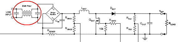

My REAL problem is how to replace the BOOSTCCMDCM subcircuit (it comes with the downloadable UCC28019 sample schematic file) in the original schematic, with the actual boost converter components (a MOSFET and a diode). I attached pictures of the "ideal" (because of the presence of the BOOSTCCMDCM) and "realistic" schematics.
How come I'm only getting an output voltage below 100 when I replace the BOOSTCCMDCM thing with a mosfet and a diode as shown in the data sheet circuit???...

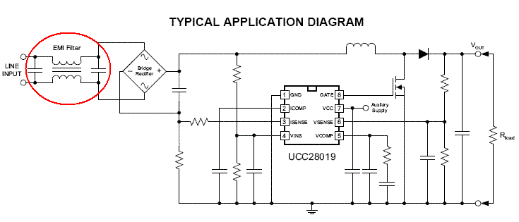

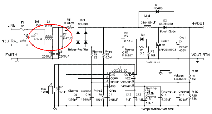

And this is the schematic from the datasheet:

A) In your circuit R33 (10K) is much too high and will slow the switching badly.
B) Are you sure fdc6322CN/FAI is a power MOSFET? When I Google "fdc6322", all I can find is a low power dual N & P Channel FET.

IMHO, you're getting current spikes at the input because you don't have a filter at the input. Note that the circuits in the datasheet all have input filters (circled in red below).
btw, EMI suppression and power factor correction are two separate issues.
It will help, but that's the least of your worries. Looking at your graphs, there's two main problems:
Firstly, the current draw in the first 300mS is ridiculous; if a circuit breaker doesn't trip in time, your circuit will burst into flames.
Secondly, after the first few hundred mS, when the circuit has settled down, the current draw at the input is horribly unsymmetrical, with a totally wrong waveform.
Getting back to the first few hundred mS, what is going on there? The output voltage jumps up almost instantly to about 450V, far above what it should be, then just sits there for 200mS without even any ripple. Meanwhile hundreds of amps of current are being drawn from the input. Where is that current going? As far as I can see, the switching transistor is shunting it straight to ground.
It would be useful to look at the gate voltage and the voltage on the right of the inductor to see what's going on with the switching.
The UCC28019 is supposed to provide PFC, soft start and overcurrent protection. Your circuit isn't doing any of those.

Anyway, thanks for really trying to help godfreyl. I asked TI directly in their forum about the whole thing and this is their answer:
A few points about the model:
1. The UCC28019 transient model is really an "Average" model that is used to test the transient features of the part. In this model, all the switching nodes have been removed and replaced with the average waveform at that node. This is required to run the simulation till ~ 2 seconds. As a result, you will not see any switching waveforms in the result.
2. The BOOSTDCMCCM block is the average model for the BOOST transistor and its interface to UCC28019 and is required for the model to function properly.
3. Startup has not been modeled in this Average Model, so please ignore the first 500ms - 1sec of the waveform as that time is required to reach the steady state.
4. The model has been tested for the 350W EVM application only. When I ram your 2.2kW application circuit, I saw distortion. However, if I reduce R23 from 30m to 20m then the distottion goes away.
