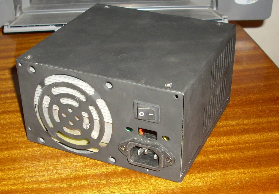

This is a project of a multifunctional charger. The maximum performance is achieved with maintaining simplicity and reliability.
Features of the device:
  • charges Pb (acid) and Li-Ion accumulators
  • has USB output with voltage 5V 600mA to charge USB devices
  • charging indicator (charging, charged, no accumulator)
  • insensitive to the polarity mistakes and short circuits
  • does not discharge accumulators with power failure
  • Li-Ion charging current about 400mA, Pb 1...1,4A
System:
The system is powered by a mains transformer wave rectifier. The system uses a rectified pulsating voltage of the network for the intended function, so if someone tried to add a filtering capacitor after the bridge, it would be impossible because both the automatics charging system and current indication would not work. Transformer should give about 18V of AC voltage, have 25...30W power and split secondary winding (in order to supply a lower voltage of USB stabilizer 5V). LED3 indicated connecting to the network. The board was made with a marker.

USB power supply:
Standard application of stabilizer 7805. Voltage is rectified by a negative half of the bridge B1. Diode D1 seems to be unnecessary (the system of power supply 5V works without it), but the absence of that diode causes incorrect work of the main charger, because voltage passes from C6 to bridge B1. Voltage for power supply 5V was taken from the center tap of the transformer.
