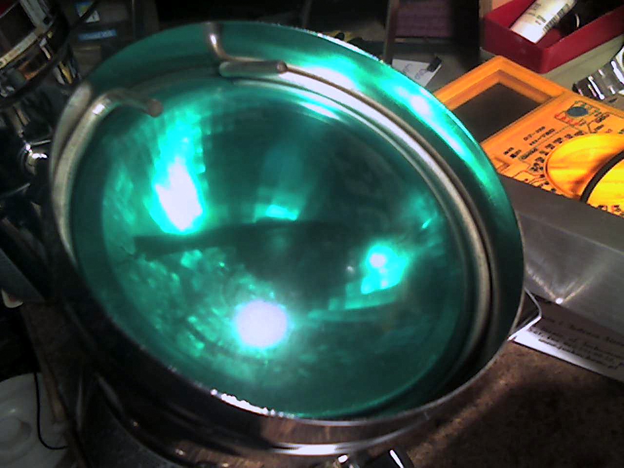

This is a construction made of old housings from PAR 36. It can be used as a backlighting.

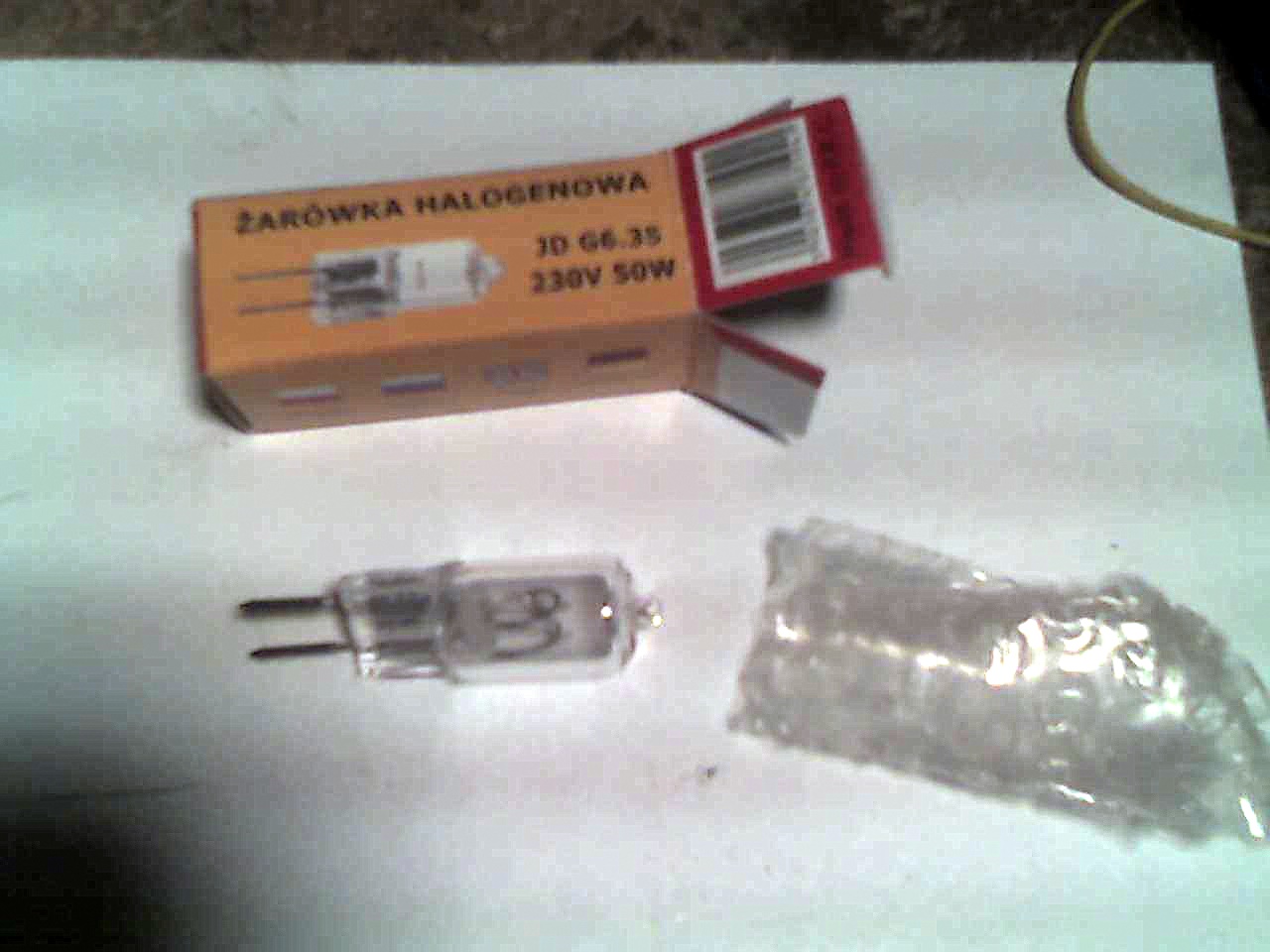

Some changes were made to the original PAR 36. There is no transformer and instead of whole glass bulb, glare was made of burned AR 111 and the lamp holder with a ¼ inch handle and a light halogen bulb for 230V and 50W.
Despite the use of voltage and increase the power of light bulbs, the structure has to be made carefully.
Elements used:
  • reflection
  • holder GU 6.35
  • light bulb 230V/50W
  • mechanic components: pieces of plate, bars M3, screws, nuts
The device is a light, neat and cheap to operate light source for use at close distances (from 1m to several meters – the best results).
It is not a single reflector, but a mobile, light weight and a neat set mounted on a square Aluminum tube, in which there are also the power input and output installed. In this way, using a single 5-wires cable and a connector, successive bars can be connected with each other. Also handles for plumbing pipes Φ 18mm, with spacing matching the size of the grid.
You can assemble the device in a few seconds, without worrying that something will fall, and if it is to stand on the floor, the handles may serve as legs. Cables were placed inside the bar, to prevent from damage, fit everything and maintain adequate insulation.
