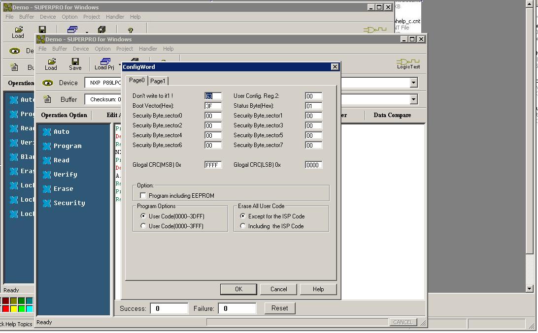

Hello all,
I am trying to program Blinky program to P89LPC936 microcontroller through a universal programmer(SuperPro). But the microcontroller is not running. Please I need help regarding it where i am doing wrong.
Here is code >>>

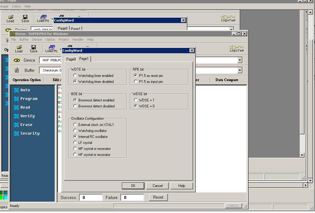

And here is the Dev Config attached settings in SuperPro universal programmer >>>

Dear mandar,
Thanks for replying, The microcontroller seems to be stuck and don't work at all, Thats what i was trying to say. I tried the port and pin configuration but it is not working. Any clue why...
R programming settings i.e. dev config are ok...

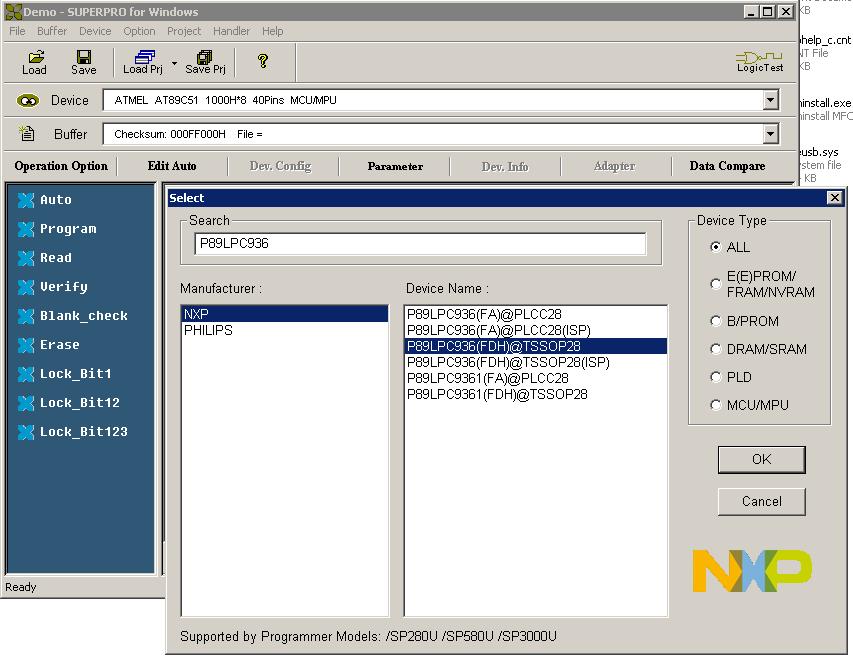

may be I just missed the entry in the list but I could not find the information that Xeltek Superpros supports the LPC900 series. And if it does not, there is no way it could work.
hth, Bob
You mean , entry from the startup .s file in the code, Yes it may be the problem you are right. But how to correct it. I have used default startup file coming with keil.
Super pro programmer does support lpc900 series i have infect checked it using a simple assambly program below and it is working fine with this.
