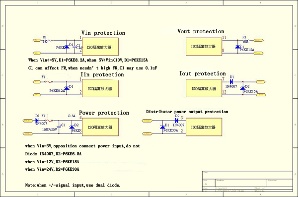

Hi all,
Is there any known an simple way to protect 4-20mA inputs for overcurrent ?
I know it is not that difficult to do to the source side of the Loop, but I am looking for to the sensing side, the way it is show at the picture below.
Is a 5.1V zener be the easiest way to get the work done or a circuit to limit the current in the loop could be more efficient to the system (source + sensing side) ?
Any suggestion will be appreciated!
Thank you! :D
From practical experience, I suggest to protect the current input against short to a 24V DC source, which can be expected to power the sensors. Obviously a zener diode without additional means (e.g. a fuse) doesn't offer any protection in this case.
A possible solution, that can be found in some PLC analog modules is a PTC fuse in combination with a mid-scale (e.g. 50 ohm) shunt resistor.
Electronic current limiters or disconnect switches are another way.
Here is an example of protection I wouldn’t do (because of it’s complexity):
https://focus.ti.com/lit/an/sbva003/sbva003.pdf
But, 5.1 V can be a bit to low, whereas 5.6V Zener should be just enough ..
If you do it together with a 63-100 mA fuse (any type will do, even PCB miniature) followed by 50-100Ohm shunt, this should provide you with sufficient protection for any 4-20mA input ..
Rgds,
IanP
Probably you can modify as show below,
analog signal converter,field protection
