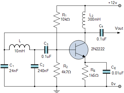

I tried searching and asking questions on few forums, but I didn't get an answer. Simple question
In oscillators, like this one
what is the amplitude of oscillations at collector? LTSpice simulation shows that it's almost rail to rail, but I would like to know what is the case in real life? Are oscillations really rail to rail?
Detailed analysis required. In the present circuit, oscillation magnitude is about 4 to 20 V, considerably above positive rail.
OK, then I have one more question. If I would want to amplify the oscillations and then send them to the antenna, should I use few stages of common collector buffer amplifiers? Since I have large enough voltage from the oscillator, for more power (range) I just need more current. I am talking about a single power source, of course if I want larger voltage I could use higher Vcc.
That depends on the antenna imedance. It will resonate at about 10.8KHz so the antenna would be huge!

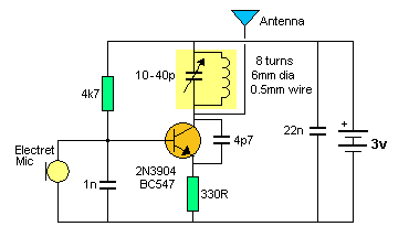

I made a simple low power FM transmitter that sounds great. I didn't design it but instead I fixed one that appeared on a forum and didn't work. My FM band is almost full of stations so I used the frequency of a weak foreign language station that is on the other side of my city.
The original circuit had its audio preamp transistor biased so that it was saturated when the 9V battery was new and the transistor was cutoff when the battery run down a little, and the sound was very muffled. So I biased the transistor correctly and added a low dropout 5V regulator. I fixed the sound by adding pre-emphasis of high audio frequencies like all FM radio stations have.
The oscillator frequency changed as the battery voltage ran down so I fed it from the voltage regulator.
The oscillator frequency also changed when something moved towards or away from the antenna so I added an RF amplifier transistor to separate the oscillator from the antenna.
Its range is across the street to an FM "radio" from The Dollar Store, down the street to a cheap clock radio and 2km across a huge river valley to my home stereo or my car radio.

I made FM transmitter too. it had range of about 300m. I never use it. I made it just to see if I can. 2km is a lot of range. As I said, the oscillator and amplifier that I built doesn't have even 50m range. With all that said, I live in very remote area with first neighbor 100m away and next 300m away. On other side first neighbor is 100m and next one is 500m away. All around us is forest for 50km until first city. I know that short wave can propagate a long distance with small power, but I am not building shortwave oscillators. I checked on my ham radio, there are no interference on HF bands. Anything above 100MHz, if I can't hear it, nobody can.

Why do you think the range of my FM transmitter is only across the street and is as far as 2km? What changed the distance?
You did not show a schematic for your radio transmitter with a range of only 50m, instead you showed an audio oscillator. How sensitive is the radio that received the signal from your transmitter? Were the transmit and receive antennas the correct length and were they parallel to each other?
There were probably some obstacles and buildings that obstructed the signal. 2km was line of sight range. The schematics for transmitter that I was talking about is this
I had portable radio receiver that had its own antenna. Antenna on transmitter was cut at approximately the length it should be. I agree that if somebody was close enough with sensitive receiver they could hear it. Just how small range do you think it should be? 30m range doesn't even clear my property. I don't approve transmitting with high power, interfering with stations that are on those frequencies, but for such small power and short range, there is no way I'm interfering with somebody.
Just putting your hand anywhere near the antenna is going to cause a massive change in oscillation frequency.
Its going to be a real challenge at the receiving end.
The whole thing is just unworkable.
If you are actually going to do this and expect reasonable results, either a quartz crystal or a surface acoustic wave resonator is an absolute necessity to keep it on frequency.
Don't worry. I know that would be the case so I put a simple FET buffer between the antenna and oscillator.
