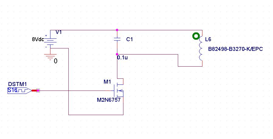

Today I tried to simulate a simple circuit to get a sinusoidal out put. https://obrazki.elektroda.pl/34_1207480182.jpg
The error is as below
Simulation running...
Reading and checking circuit
Sub circuit B82498-B3270-K/EPC used by X_L6 is undefined
Circuit has errors ... run aborted
See output file for details
Simulation aborted
I couldn't find Inductor pspice models. So Imported that from
https://www.cadence.com/products/orcad/downloads/pspice_models/index.aspx
and I found those epocs.lib, epocs.olb there. Tell me what should I do.

What version of OrCAD do you use?
First, you cannot apply digital stimuli (DSTM1) to an analog input.
Second, I do not know why you didn't find the inductor pspice model (L) - it is in the analog library.

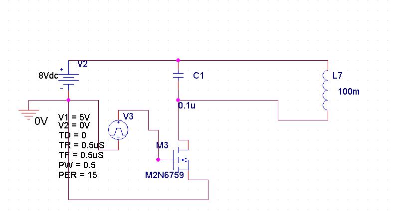

I resigned the cct again. Have a look at that. https://obrazki.elektroda.pl/28_1207482956.jpg
Error is
--------------- Simulation Profile: SCHEMATIC1-ganapathi ---------------
Less than 2 connections at node X_L7.X1.3
Less than 2 connections at node X_L7.X1.11
Simulation aborted

Re: Orcad again....
Try to see what are the pin numbers of L7 - probably it has another pins, or you didn't use the correct net names.
And take the L from library analog.olb.
I attached you circuit and simulation diagram.
