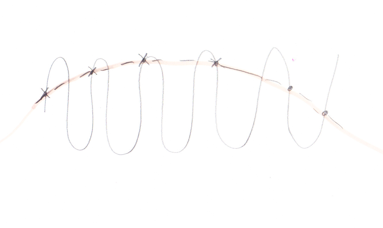

Here is a sine wave that is sampled at below the nyquist rate (i.e. sampled at every "x"). The output of the sampler looks like a much lower frequency than it really is.
That's not a valid representation. In between samples you can't assume any value. If you took enough samples and did a Fourier analysis, you'd see the fundamental frequency is really there. (And I'm assuming that's supposed to be a sine wave you drew. )
when someone says "here is a sine wave"...it is pretty safe to assume it is a sine wave. And that is a valid representation of undersampling.
