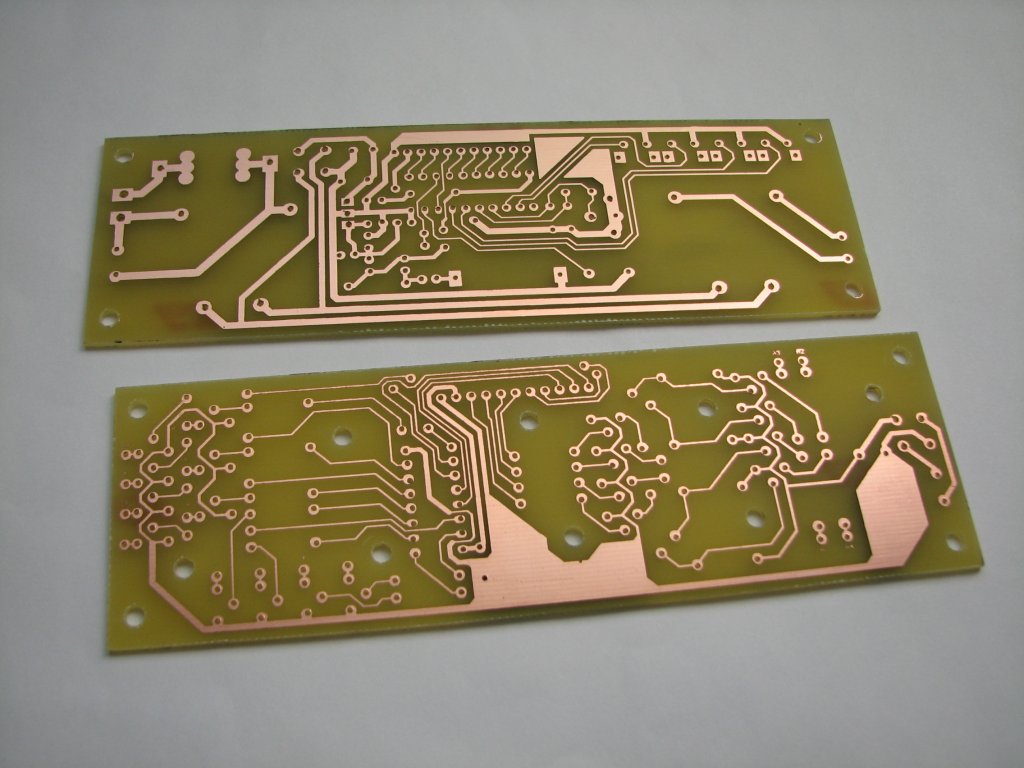

The construction is typical. Multiplexed lamps were used, so that Attiny2313V may control the whole.
Because of the often occurring problems with activating the transformer for powering the lamps, this part was built in an other way. For making the high voltage for the lamps, second transformer TR2 was used, connected by secondary windings to the secondary windings of TR1. Transistors were used to connect them to a cheap decoder 4028. When broken, there would not be necessary to change the whole system, but only a single transistor. The construction was placed on two plates: the clock on one of them and the driver for lamps on the second one. Stands of the lamps were screwed to the driver. P1 is a simple piezo plate without generator. An accumulator is used to maintain the power supply, it should last for more than two days.

Zener diodes D3-13 on the plate of the driver should be mounted from the side of paths, because there is not too much space, and because of the high voltage, too decently placing components is not recommended. SMD or simple diodes with close-cut outputs may be used. The plates may be connected to each other by connectors or flexible cables.
The clock can be customized by any nixie lamps. Just make an additional third plate (e.g. universal plate screwed to the other ones), with attached lamps, and the whole clock can be positioned horizontally or vertically, depending on whether the lamps display numbers from above or the side of the bulb. When the lamps do not have dots, little neons with properly selected resistors may be used. In this model the transformer with the voltage of secondary winding 12V, slightly higher than TR1 (9V) was used, in order not to get too high voltage for the lamps with no load. In such combination the voltage under load decreases quite rapidly, in consequence of which obtaining a maximum current of 2-2,5mA at a voltage of 165-170V is real.
