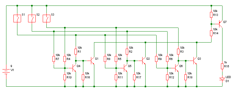

Above is a (rough) schematic of the circuit I'm trying to build. Here's what I'm trying to do: I have three toggle switches that make it possible to activate a load down the line. I want it so that if one toggle switch is on, the signal goes through, but if two or more are active, the circuit will shut down. I thought I could achieve this by using three NPN transistors and six PNP transistors as shown above. I'm trying to set it up so that the NPN transistors function as normally-closed electronic switches, and the PNP transistors function as normally-open electronic switches. I've managed to build and test each component of the circuit. But when I link two PNP transistors together as shown, there isn't enough current (I think) to activate the LED. Is there something wrong with my set up? What do I need to do differently? Or is there an easier method to do what I'm asking?

OK, I gave up trying to understand your circuit, but this one should work.
Firstly:
Q7 (on the far right) switches on and lights up the LED whenever Q1 or Q2 or Q3 are on.
If only one switch is on at a time:
  • If switch 1 is on, current flows through R1 and switches on Q1.
  • Same story for switch 2, R2 and Q2 as well as switch 3, R3 and Q3.
If more than one switch is on at the same time:
  • If switch 2 (or 3) is on, current flows through R7 (or R4) to switch on Q4. Q4 switches off Q1 even if switch 1 is on and current is flowing through R1.
  • Similarly, if switch 1 (or 3) is on, current flows through R8 (or R5) to switch on Q5 and make sure Q2 is switched off.
  • Also, if switch 1 (or 2) is on, current flows through R9 (or R6) to switch on Q6 and make sure Q3 is switched off.

I realized later it can be made a bit simpler. If you leave out the last transistor and turn the whole circuit upside-down, you can drive the LED directly from Q1, Q2 and Q3, as in the picture below. That way, you just need 6 PNP transistors.
