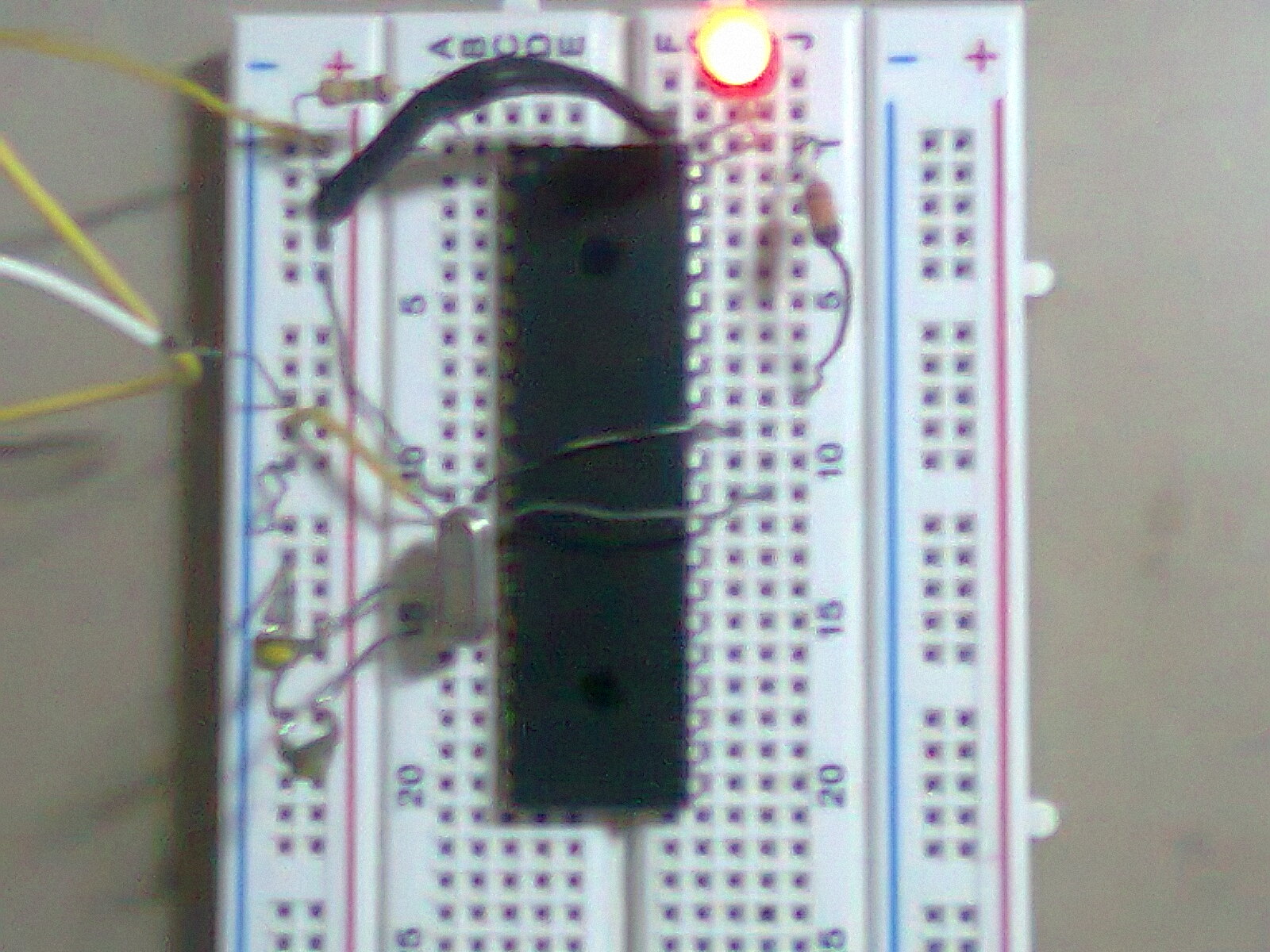

hello im makeing a led project with my PIC16F877A
and this my code

and my designs and the led blink and open
but when i try it on my breadboread the led go on and dont blink and open its just open

If that is your actual circuit then I'm afraid it is totally wrong.
Have a look at this tutorial -
I will add a valid schematic for your 877a in a few minutes, though there is a chance you may have already damaged it as it can only cope with +5V.

You really need to use a 5V regulator like that shown in the diagram.
Using a dropper resistor would work if your current was constant, but its not as the led is flashing on an off.
The 877A takes about 3ma and the led about 20ma so the voltage would fluctuate badly; the micro is designed for stable power only
The best solution would be to use a 4.5v battery or 3 x 1.5v cells connected in series.
You could possibly create a potential divider across the battery to produce 4.5 volts but thats not something I have tried.
To progress onto anything more complex you will need that voltage regulator.
Another thing to be careful of when using the breadboard, the 22pf capacitors and the xtal have very thin leads and they do not always make good connection into the beadboards sockets.
If possible solder some thicker wire onto them to make the connection stronger.
Also its important those three parts are as close to the 877s pins as possible.

you don't need these settings as you are not using port a. Have you set the clock frequency in mikroC and proteus properly? Are you using internal / external oscillator?
Looking at your pictures the circuit is incomplete.
You must have the positive and negative connections to the Pic.
You must have a crystal and capacitors or some other form of oscillator.
You must have Pin1 Mclre pulled up to positve
Without these it can not work.

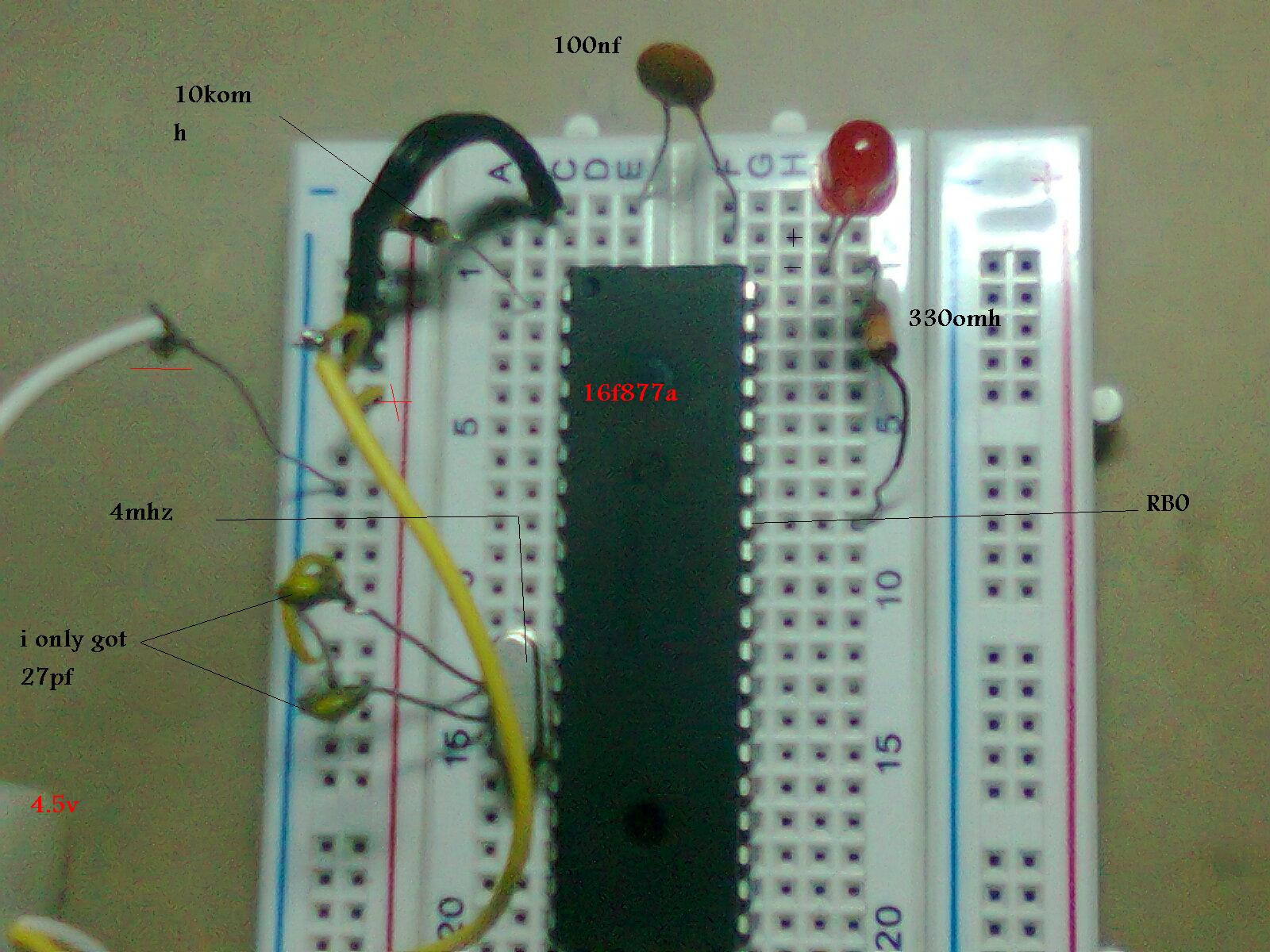

    hesho90
Fez877 PIC JDM Programmer for Microchip MCU
Thats looking better with the correct parts but its not quiet right - simple to correct though.
The 100nf cap should be removed from the led, the led + should connect directly to your + rail.
What you are missing are the + pos and -neg connections to the 877A to give it the power to run !
The + pos should be connected to pins 11 and 32
The - neg should be connected to pins 12 and 31.
Then connect the 100nf cap across pins 31 and 32, this helps reduce any interference on the power lines.
The 27pf caps should be fine with your crystal
Hopefully that should work .. let us know how you get on.

    hesho90
IT WAAAAAAAAARKED :grin::smile::-o
Thank you very match man your post did post #13 and #18 really didit man
