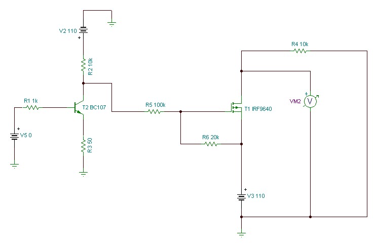

Find the below schematic...
Actually i need to convert 5V to 110V using p-channel MOSFET.
input 5V is coming from the Microcontroller and Mosfet should generate 110V to drive the external relay with 3A.
here i have attached schematic which i have tried in simulation...
I am using IRF9640 p-channel Mosfet. In schematic the transistor collector is connected to the 110V and the output is taken from the drain of MOSFET...In this condition i can able to switch ON/OFF the MOSFET properly....
But actually my system have only 5V,12V and 110V power supply only...So in the transistor collector i should use only 12V...If i use with 12V i cant switch the MOSFET...I think the MOSFET is always ON...I cant switch OFF the MOSFET...
So can you suggest me in this design????
https://obrazki.elektroda.pl/54_1302088635.jpg
yes you are right to wouldn't be able to switch OFF the Mosfet. but in your circuit i see 110V supply on the transistor collector in this case you can turn it OFF and ON why not use why not usse in this config..?
all you need to do is to select a suitable transistor with enough Vce rating...
In this configuration i can switch ON/OFF the MOSFET but i should use only 12V only in the collector side.....this is sample schematic only instead of transistor i should use only optocoupler for isolation at that time i should use only 12V in the collector side...this is only my problem...

You can use level shifting so that the gate gets 110 or 100v (so that Vgs stays below 20v) using a voltage divider in the collector.
Alex
then again you have to use the optocoupler before the transistor....
or the output (transistor) of the optocoupler instead of the transistor shown in the schematic (assuming that 110v can be used with the optocoupler transistor).

my main problem is that, i should not use 110V in the collector transistor or optocoupler output....I should use only in the P-channel MOSFET itself only...i should use only the 12V in the collector of transistor or Optocoupler output.....
well the easiest way is to use n channel Mosfet rather P channel all of your problems will be resolved.....
try IRF640N....
