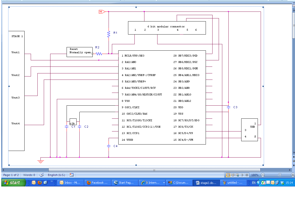

as part of my project I'm facing some problems while trying to establish connection with the MPLAB ICD 2 debugger.
when i'm using the Microchip board everything works just fine (debuger, programmer), but when i try to connect in a debug mode to my own design I get constantly an error message Warn0020:Invalid Target device id(expected=0x93,read=0x01).

You can download the ICD2 manual from here https://ww1.microchip.com/downloads/en/devicedoc/51331b.pdf
Assume you have wired things up as shown in that manual.
If things worked on a dev board but not your own board then its likely you have got things wrong on the PGC / PGD lines.
Do you have anything else connected to those lines other than the ICD2 ?
Have you got anything else connected to Mclre other than the ICD2.
What Microchip board and what Pic chip are you using ?

The chip I use is pic18lf2455.
furthermore, after promgraming the chip on release state (microchip board), the code run successfully in my own board. (this is how I know that the clk and the other enviorment is working well).
but when i tried to program on debug state on the microchip board, it didnt connected to my own board with he following error : ICDWarn0020: Invalid target device id (expected=0x93, read=0x01)
I did connected a reset button (switch) to the MCLR.
it is connected with two resistors as mentioned in the attached image.
(R1=10Kohn, R2=10ohm)

To me everything looks ok with your circuit.
I only use the Pickit2 debugger, but don't think there is anything that different.
One thing that might be the cause is the distance from the ICD2 to the pins on the 18F, sometimes I find if its greater then 6" /150mm you can have strange problems even programming.
The fact that you can program in your board and debug on the dev board, must be missing something obvious ... ?
