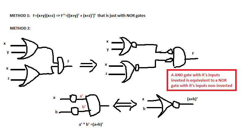

That is the question. I have drawn a truth table and a circuit using AND gates however I dont know how to put the requirement of the cutter operating only once when in maintanence mode into a truth table or how to convert my circuit to NOR gates. I have tried substituting the AND gate for three NOR gates but this effects my truth table and I am unsure as to where the inputs would go with three NOR gates and how I could improve the circuit for better MTBF. I think I could try to reduce the number of gates but I would be unsure as to where my inputs would go again.

Draw the Karno map and design the safety circuit using two input NOR gates (use as many as you require).
The steps to draw whatever circuit using only NOR gates are as follow:
1)Take the truth table and simplify it in "maxiterms" (products of sums). To implement that you would have to use OR-gates on the first level and AND-gates on the second level.
2)Here 2 ways could be used(choose the one you like, it does not matter):
METHOD 1: Take your simplified function in 1) and deny it 2 times(invert it 2 times... I do not know how is that called in English but I will show an example). Use de Morgan rule and there is the result in NOR gates.
METHOD 2: At the output of the first level OR-gates place on them the inverting point and at the input of the 2nd level gates (AND-gates) as well, now the 2nd level gates are NOR gates. There is the result in NOR gates.
EXAMPLE: Suppose we have F=(x+y)(x+z) => see picture
