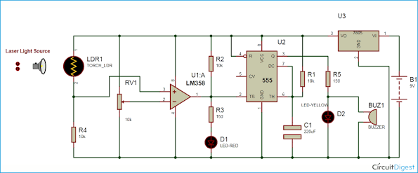

I just wanted to build a laser security alarm that buzzer turn off in a certain of time when no one can hit manual reset. My real problem is, I can not create a diagram like that. Would you help me to create a diagram for that so I can start building my own project laser security alarm.
A laser security alarm that has a timer to stop the buzz in a certain of time or can manually reset to stop the buzz.
In this circuit diagram,
is it possible to put a manual reset?
I want to build a laser security alarm that will stop the buzz automatically in a certain of time (for example about 2 minutes) when no one can hit the manual reset.

If you only want to add a button to turn off the buzzer, then you can do it this way:
Sorry for Painting on the image, a quick way of drawing it...
If this is a battery-powered circuit, while the 7805 is a great regulator, you will find the circuit will work longer before needing to change the 9V battery if you change it to any suitable 5 volt (fixed voltage) Low Dropout Regulator - if you do this, there are a lot to choose from so try to select one that says it can operate from up to 9 volts at least and is capable of 1 Amp output, or 0.5 Amps.
You can use a 7805, but when the battery voltage drops to about 7V, the circuit may work a little erratically as the regulator will no longer be regulating its output voltage - it needs at least 2 volts above 5V to function correctly and regulate the 5 volts output, that is all.
For about 2 minutes, if you use a 6 million ohm (6 MegaOhm) resistor and a 22uF capacitor it really would be a preferable combination compared to using whatever resistor is in that circuit and the 220uF capacitor it shows. Or 1.2 MegaOhm and 100uF if you have to use a large value capacitor.

Okay, the schematic you have for the 555 laser alarm/light activated alarm is one you can use. Post #9 shows how to add a button to reset it.
Change R1 from 10k to 1.2 MegaOhm and C1 from 220uF to 100uF for it to be 2 minutes on (after about two minutes it will turn off).
